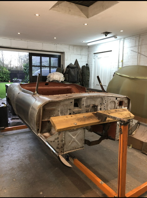

#3 Re: 1965 FHC on a Rotisserie Jig
Use (2) engine stands with rear bolted to license plate panel. On the front the it is attached to picture frame. Front suspension is in place. Clearance in my work space dictated a point of rotation above the picture frame secured with steel angle iron.

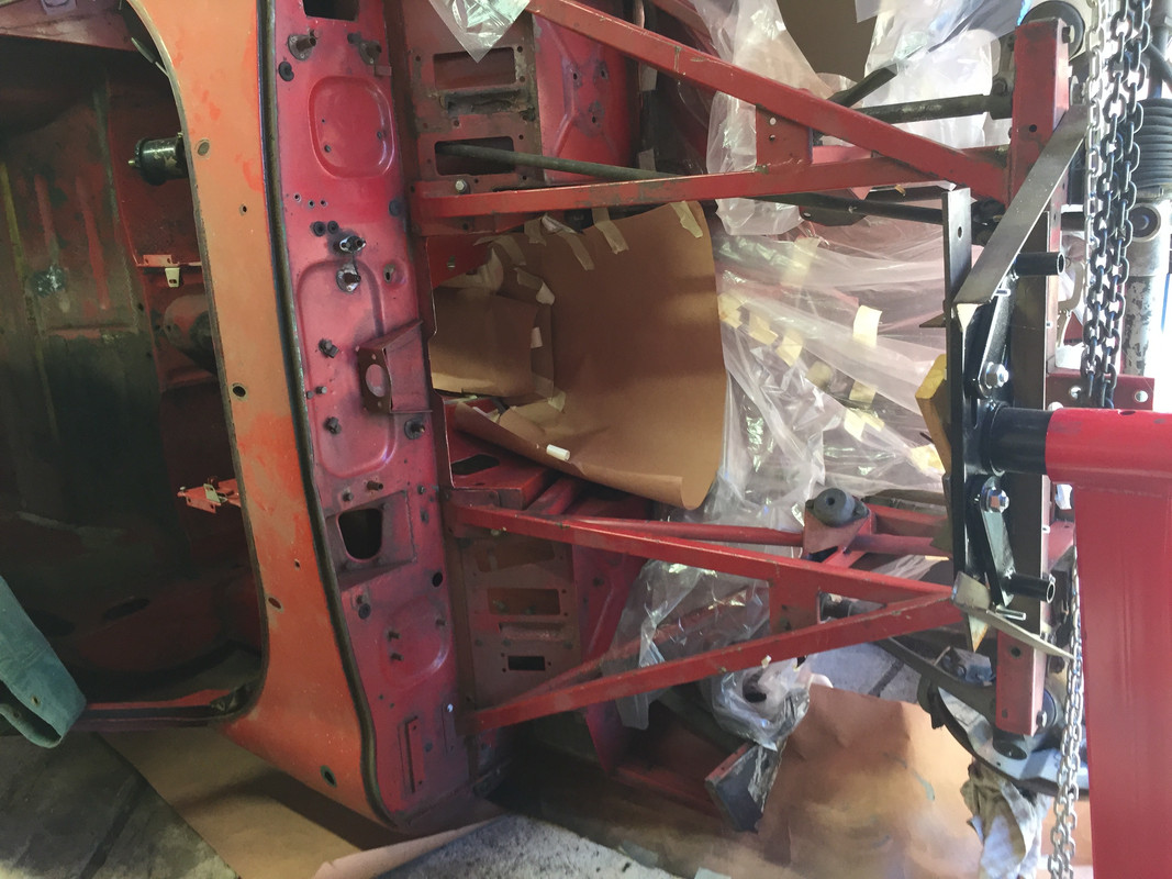

#4 Re: 1965 FHC on a Rotisserie Jig
Hi i had mine on a rotisserie, I copied what I saw up at Hutsons, see the pic it worked a treat.
Sorry Keith think I’m missing the point here.. you don’t want to remove the frames I just read your question again. I’ve left the post up and pic incase it helps you seeing how I mounted mine, you could do similar with a longer pole to the rotisserie frame work from the bulkhead, maybe create something on the picture frame just to help balance/stabilise it… think the bonnet support will definately have to come off.
However, as a previous member said speak to Andy at Hutsons he is not only the most helpful fella you ever going to speak to but also one of the most knowledgable. Dealt with him for years.. first class
