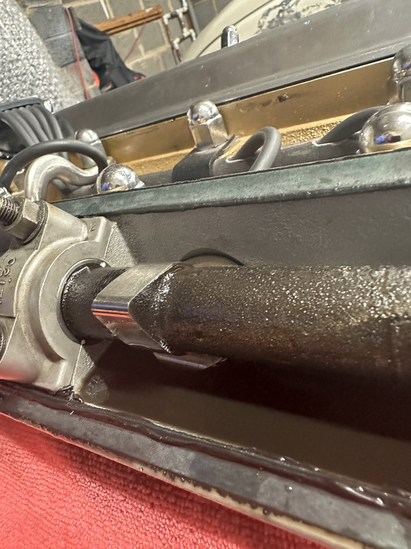

Advice please on valve clearances
Long time restoration nearly complete and running ok

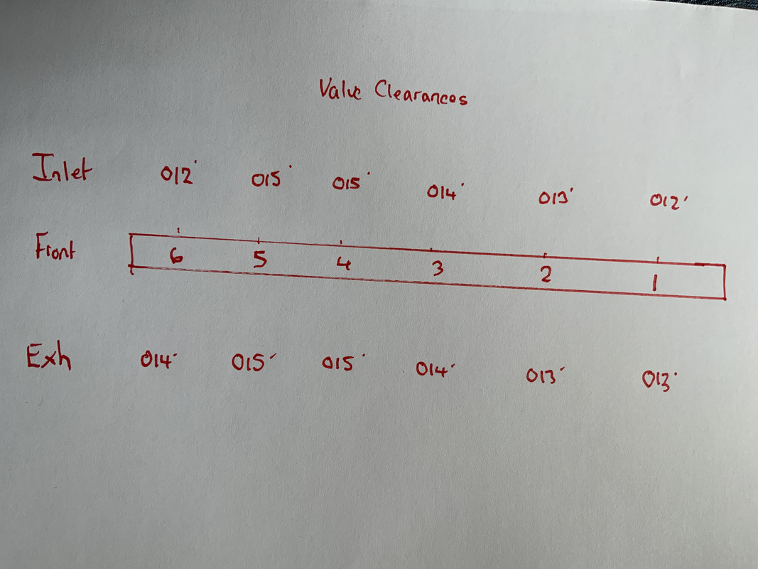

Having checked valve clearances I have the following measurements
The head has the 4 bolt cams fitted so I am told 0.012 - 0.014 for both inlet and exhaust
Should I adjust from the current setting and try to get all valves to say 0.013 ?
My dilemma is in people experience can you get all clearances the same ?
See attached pics of clearances
Any guidance welcome

Hi....yes you can get them all the same...but your checking these with a feeler guage in an awkward position......personally whilst your in there I would change the cam bearings if they have been in there from new....and use a torque wrench to tighten them so they are all exactly the same.....then measure your gaps...and set as requires..13 in the middle is ok to aim at....you will probably have the check them all at least 3 times to get them where you want....long and tiresome...Steve

There are only four which are outside the specification , and these only by 1 thou . Frankly, I regard it as impossible to measure accurately to 1 thou, ( particularly if not all the valve gear such as buckets , bucket guides etc have been replaced) , and my advice would be to leave well alone unless on running the engine it is unreasonably noisy at the top end

If it's not noisy and runs fine I'd leave it alone.
Setting the clearances with the head on always carries the risk of accidental valve damage or dropping things into places they shouldn't go.
