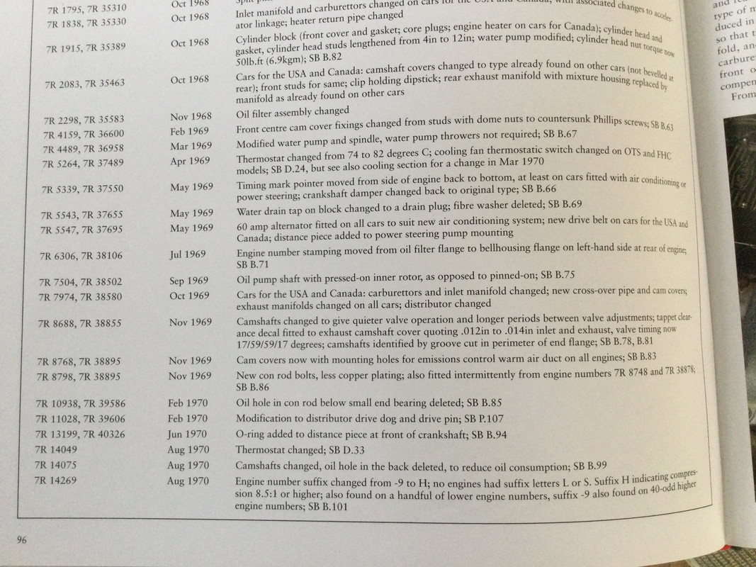

#15 Re: Tappet Lubrication from cold
Have a look here...read post 10.....3 sets of cams used on S2 E types....Steve viewtopic.php?f=3&t=11681&hilit=Parabolic+cam

#16 Re: Tappet Lubrication from cold
Thanks Steve,
I had assumed that “END” related to End of XJ6 Series 3 production, but I am probably incorrect in my assumption.
I have also read the Georgia Jag article which states the lobe oil holes were deleted when 4 hole cams were introduced, but in the Clausager book it says lobe oil holes were not deleted until Aug 70?
C35555 and C35556 are listed on the SNGB website as XJ6 Series 1 camshafts, and late E Type Series 2 camshafts are C41680, which is apparently incorrect.
Either way, my car does not have lobe oil holes, and with so much confusion over camshafts, I think it is probably worth drilling holes in the lobes and see what happens.

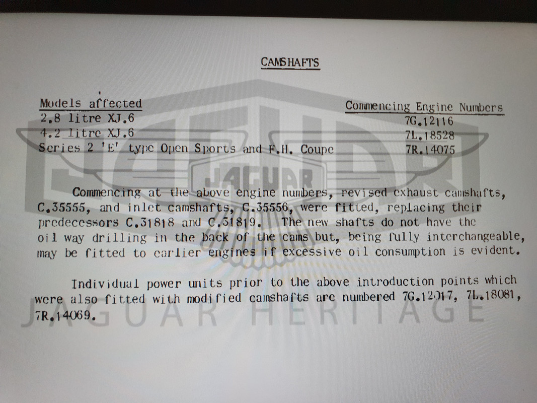

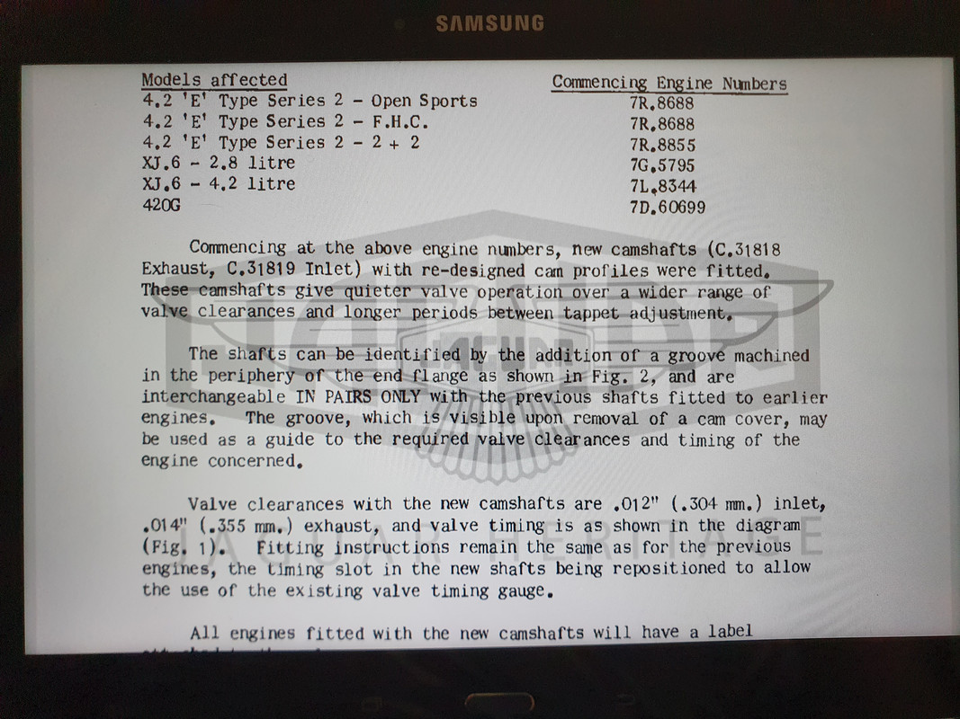

#17 Re: Tappet Lubrication from cold
Here is the service bulletin note the gap of 12 and 14 are incorrect and was detailed in the next Bulletin as 12 to 14 .....Steve

#18 Re: Tappet Lubrication from cold
Thanks Steve,
Amazing information as usual!
So, my cams could have come from either a late E Type or early XJ6.
All I need to find out now is when the change to a direct cam oil feed took place. As far as I know this was not during E Type production, but was it done to improve oil supply to camshafts, without going back to holes in cam lobes?
