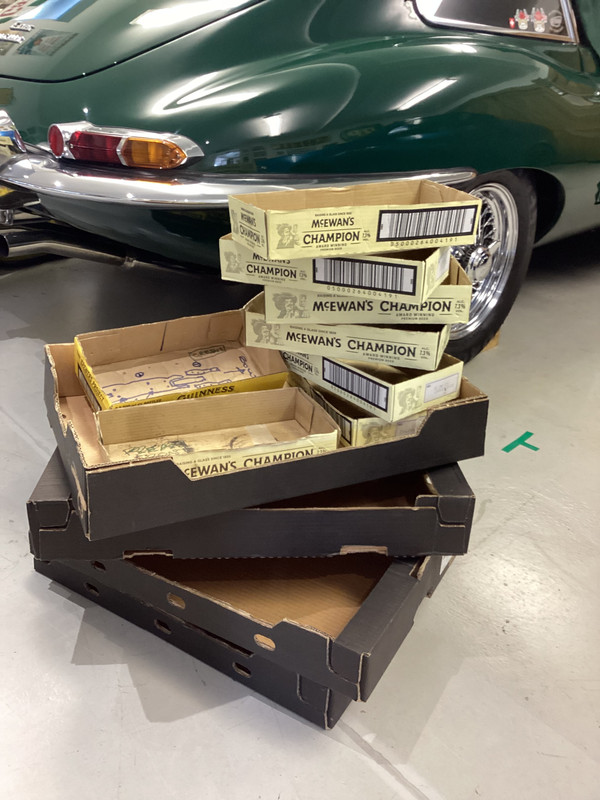

Only just seen this post, but in addition to taking loads of digital photos, to answer the question on how I stay organised when I tear assemblies apart is to take a trip to my local supermarket and collect dozens of what I call “banana boxes”. These are long, flat stackable cardboard boxes which fruit is delivered and the store is only to happy for me to take them away.
I carefully choose matching boxes so the stacking lugs all match and also pick the best boxes without too many holes punched in the bases, so small parts cannot drop through. These boxes are strong and are used for the larger assemblies plus depending on the box depth, can be stacked to quite a height. For smaller parts, I also use the smaller beer surround cardboard bases - this usually requires drinking quite a lot of beer, but I am prepared for that challenge !
The benefit of both storage facilities is that I can write on the cardboard and even punch fittings and bolts through the cardboard showing in the direction and orientation from their original location directly marked onto the storage unit. Once finished, the cardboard is disposed of by recycling.

Genius, Dave! Especially engineering a means by which more beer must be consumed out of duty.
So I'll now be taking a lot more pictures (and videos!), taking notes (loose leaf!), keeping small parts in sharpied ziplocs aligned with a tracking sheet, using carefully-curated stacking boxes and drinking more beer.
