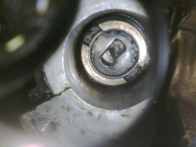

I’ve tried running the generator with a 1600rpm drill. That didn’t give a consistent rpm figure on the gauge, the readout just hovered around 500-1000 revs unless I blipped the drill when it would momentarily go up to around 2500rpm. Also tried to take a pic of the generator dog drive - does it look ok?

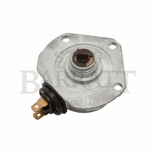

The generator works using magnets to produce a AC voltage pulse. The magnets lose their strength over time which means the generator does not provide sufficient pulses. Before messing with the tachometer, and repairs can be expensive, invest in a new generator (£186) which should look like this:
Your photo seems to suggest something is broken.

Post by mgcjag » Fri Jul 21, 2023 6:20 pm
I have read somewhere..JagLovers.. I think about repair to that drive dog....probably worth a search...Steve

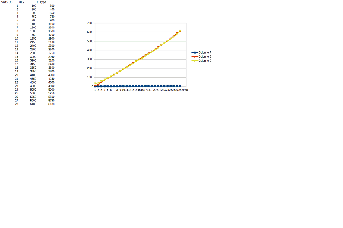

"Therefore, with the 15 VAC input to the tach gauge, the reading on the tach gauge should be 3000 rpms, not 1500 rpms.
Tom"
I confirm these values as I tested the tach gauge with variable DC voltage inputs: here the results, comparative between Etype and MK2
Jaguar MK2 1967 since 1980
Lotus Seven 1963 since 2015
XKE S1 1964 OTS since 2023
#20 Re: Rev counter behaving badly
Post by christopher storey » Fri Aug 18, 2023 10:28 am
I hope you meant variable AC inputs! :bigrin:
