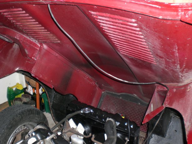

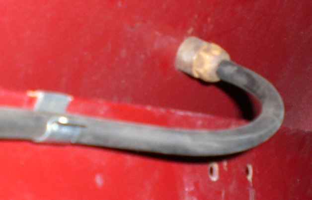

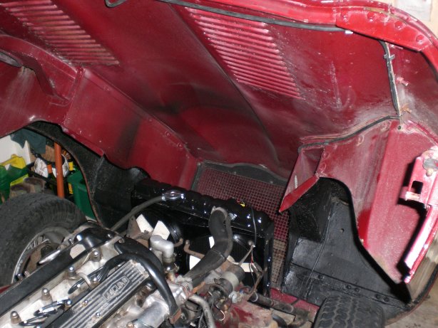

Further viewing of 2+2 pictures only, showed the pipe followed the inner wing round, clipped in some way.
Before picture:
I sourced some new pipe and spoke to the staff at Woolies, who were very helpful and directed me to another company called Bresco. They have clips of all descriptions and had the required brackets; a close up of one can be seen in the picture below:
The finished job is a lot neater I?m sure you?ll agree, see picture below:
Before picture:
