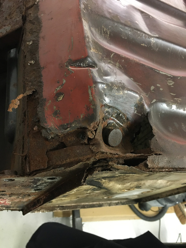

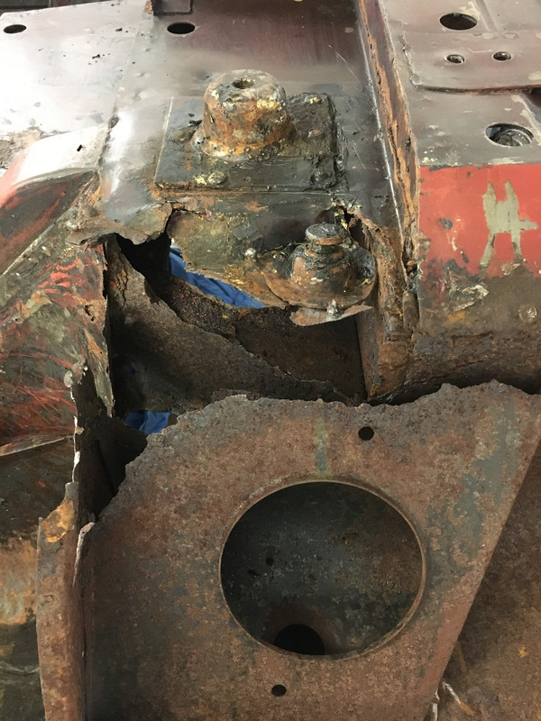

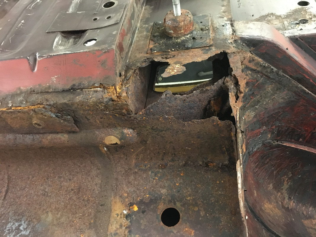

thanks for the photos, it looks worse than it is really, not too much to do. You could buy one of the cheap invertor TIG machines, they are DC only so you cannot weld ali but will be adequate for most of this job. If you are experienced with TIG you are half-way there, plug welds done with finesse with the TIG will be perfect too. Its best to cut out and replace than try to straighten 16 gauge steel, but I'm certain that you have the skills to do a great job on this car, good luck with it, cheers John. PS view marketplace on Facebook for your area you often see MIG, TIG and plasma cutters at really good prices close to your home.

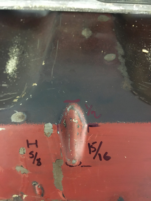

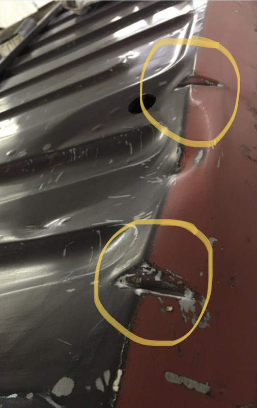

Your photos reminded of a question I have regarding replacement Martin Robey floors.
On the original floors there are 6 indents spaced along the length of the floor. These are missing from the replacement floors.
Has anyone made a tool to replicate the indents? Or come up with a different solution?

Hi I thought a photo ( one of Richard’s) would be helpful to support my question above.
Many thanks
Nick
Many thanks
Nick

I have two methods.
1. When no helper is available, I use a template of the outside shape of the gusset, to mark out an area to cut out. The preformed gusset is TIG welded in place.
2. With a helper, I use a hand held Punch and Die Set to form the gusset without any cutting and welding. The Die Block is held in place on the inside of the floor, and the gusset formed with a punch from the outside of the floor.
The gussets shown in the following picture were formed by welding in the gusset form.
Hello Nick.Has anyone made a tool to replicate the indents? Or come up with a different solution?
I have two methods.
#16 Re: Chassis straightening
Hi Nick,
If it helps I have taken some measurements for you. The drill bit is 6.3mm. I have 6 of these on each side.

Hi Bill & Richard,
Thank you for your very helpful replies.
I wanted to add the gussets to ensure the correct appearance.
Seems strange to me that Mr Robey has omitted this feature from the repro panels.
Excellent that I now have a solution.
Thanks again
Nick

You will note that although the plan detail of the forms across the floor are correct in the Robey Floor Panel, their cross section is not. The shape of the bottom of the features in the Robey panel is flat, while the shape of the original is curved.
This indicates to me that the Punch and Die set is a cheap arrangement where the male punch component has flat forms, way less costly to program and machine than the correct curved cross section, and the die plate component probably just a thick plate with cutouts the outside profile of the features cut all the way through, which can be produced fairly cheaply by a number of methods.
I suspect that the angled side edge of the floor, are merely folded and therefore, circumvents creating the gussets unless done so as a further operation. In the original production of the floor panels, the punch and die set would have been solid tools carrying the correct cross section profile of all the features in the floor.
Hello Nick,Seems strange to me that Mr Robey has omitted this feature from the repro panels.
