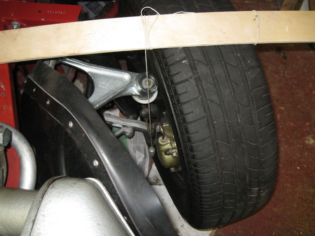

I used a plumb line (and basic trig) hanging close to the top and bottom ball joints with the car on a level surface. It is accurate enough to set each side to within manufacturers tolerances.

Posts: 1597
#17 Re: Castor adjustment
Post by chrisfell » Tue Oct 17, 2023 4:31 pm
Paul,
The link to Jag-Lovers hasn't got this photo.
Sort of helps to see exactly how i did it.

Post by Paul bow » Wed Oct 18, 2023 4:05 pm
Many thanks guys great help as ever..
And Chris that picture explains exactly how you did the job, much appreciated.
