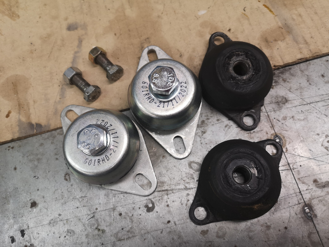

I’ve just replaced my mounts after those in place failed after a very short time.
I also used the uprated, steel capped,ones from SNG.
Side by side they are significantly larger the the rubbish I took out. Raising the engine as far as possible to get them in. They do appear robust.

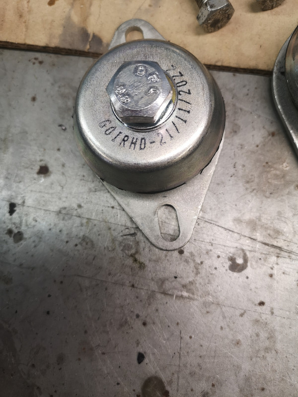

#8 Re: Series 1 and Series 2 engine mountings
Some details about the C1855CU "uprated" ones - which incidentally are also Series 1 compatible.
They are indeed generic ones that are considered "close enough" to be sold to Jaguar owners, but selling them relies - as is now customary - on their ingenuity and dexterity To Make Them Fit.
If the Usuals were sufficiently forthright to warn prospective purchasers then I would think this was OK.
But flogging them as "Uprated" replacement parts, full stop, and at a Premium, is pretty dishonest.
1. They won't take the original 3/8 UNF bolts, as they're designed for 8mm fixings.
2. The centre-to-centre of the holes - which are oval - is not even the same as the originals.
3. Fitted, they overhang the engine-mounting supports.
It's fine, 5-minutes of clever work with a file will make them fit.
But it leaves a nasty taste in the mouth, and to pretend anything else would require an empathy up there with the Stockholm Syndrome.

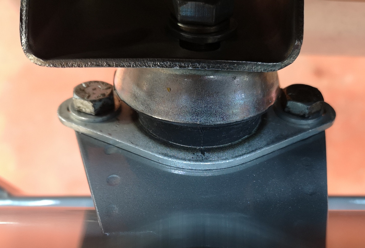

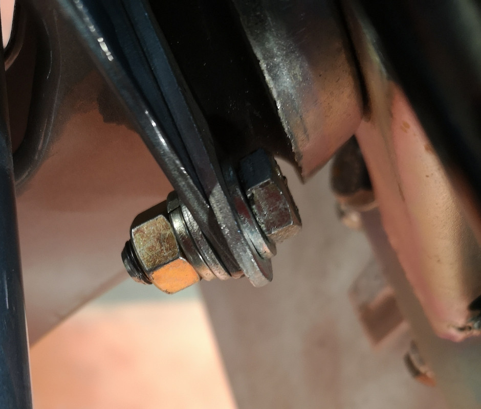

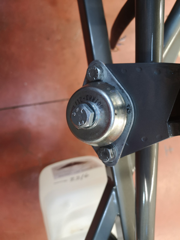

#9 Re: Series 2 engine mountings
Hi Rory...i see you have fitted large washers under the head of the bolts holding the mount to the frame....take care that this dosnt cause metat to metal contact of the two halfs of the moung when your engine is mounted.....Steve
#10 Re: Series 2 engine mountings
Interesting point.
You really have to use a washer there as the oval (and filed) hole is a way-less satisfactory seating than with the original rubber support.
I reckon there's probably 3mm vertical separation, to use up first, before contact, when the horizontal separation is then on the limit of being zero.
So you could grind a couple of flats on either side of the steel cone and all would be fine.
This takes us still further away from the "Upgrade" we're being sold, mind.
