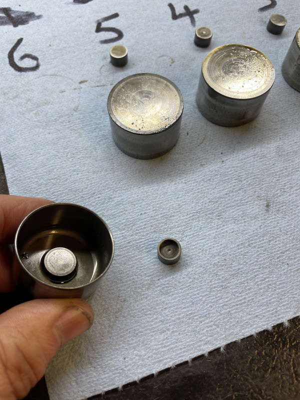

This engine keeps giving!!
Just removed the valve buckets and shims from the inlet side and found these:
Has anyone ever seen these before?

Well, I think I’ve found my answer - they are top-hat shims used in racing due to their low mass. They are accompanied with matched racing buckets. Nice.
Thanks for everyones input on this.
