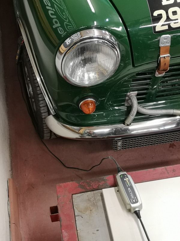

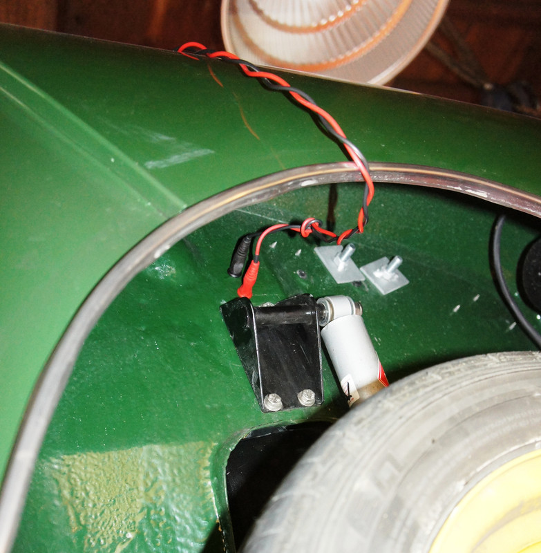

I've used CTEK 0.8's for 10+ years to keep the Mini and the Jag on a permanent drip-feed.
Both run Advanced Glass Mat batteries.
I use banana-plugs and sockets, with an in-line fuse on the car side.
Wheel arch for the Mini.
LH under-tray on the Jag.
True, I don't drive much in the rain ........
