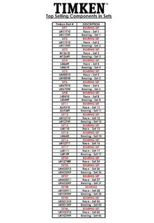

#7 Re: Bearing Choice
Post by mxke » Mon Aug 28, 2023 11:04 pm
Wheel bearings can be purchased in "sets". I believe the E Types are a set 2 and a set 6 for the inner/outer, but check the numbers.

#8 Re: Bearing Choice
Post by Dad » Tue Aug 29, 2023 12:29 am
Many thanks
mxke wrote: ↑
Mike
