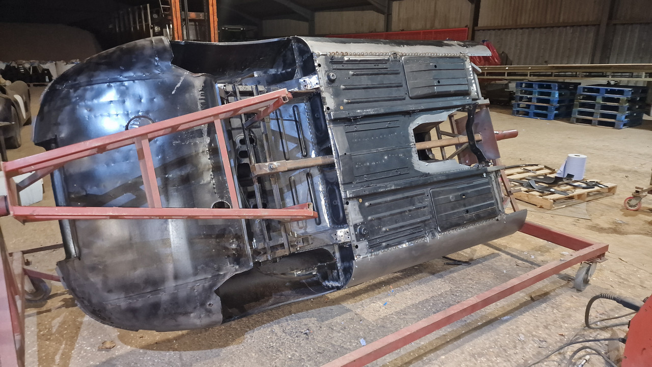

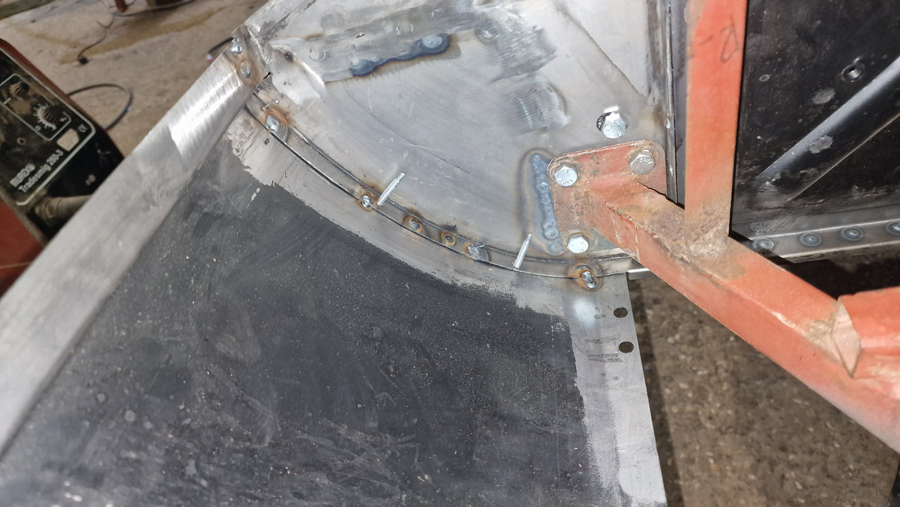

#9 Re: How to secure sill to sill closing panel?
I fitted a pair of Mr Robeys outer sills this afternoon.
They have slightly less of a radius than the closing panels. This is on purpose I think. It allows you to pull them into the closing panel flanges to get rid of the gap for plug welding, using tek screws.
I finished about an hour ago, I will clean up the weld tomorrow.
They took longer to weld in than to fit, as the fit was perfect once they were pulled in, it took 15 minutes per side to fit them, much longer to clean them, punch/drill the holes and weld them in.
I was attaching them to Robey sill closing panels at both ends with a few tacks only.
I have fitted a few pairs of these and they have never given me any trouble.
I wont go into the details on the main floor/sill bulkhead welds, however it requires a hole punch and quarter inch drill bit if plug welding. About 80 of them per side I would guess.
Drill the plug-weld holes in the closing panels first unless you are using a spot welder. Use thinner to remove the paint from the panels.
The rear outer sill panel has to be clamped onto the floor near the closing panel.
The center of the panel slides underneath the jacking point on the new floor and clamped to the inner sill where the door shuts.
The front needs to be clamped against the inner sill in front near the bulkhead.
To tighten the radius of the outer sill against the closing panels I would advise using 7mm head self tapping tek screws on a quarter in drive electric drill.
Screw through the pouter sill into the closing panel flange working from the top of the closing panel to the bottom, using three screws to bend the outer sill into the radius of the closing panel flanges.
You will find that the gap closes up perfectly.
I then tacked the closing panels along the sill using plug welds as they follow the profile perfectly.

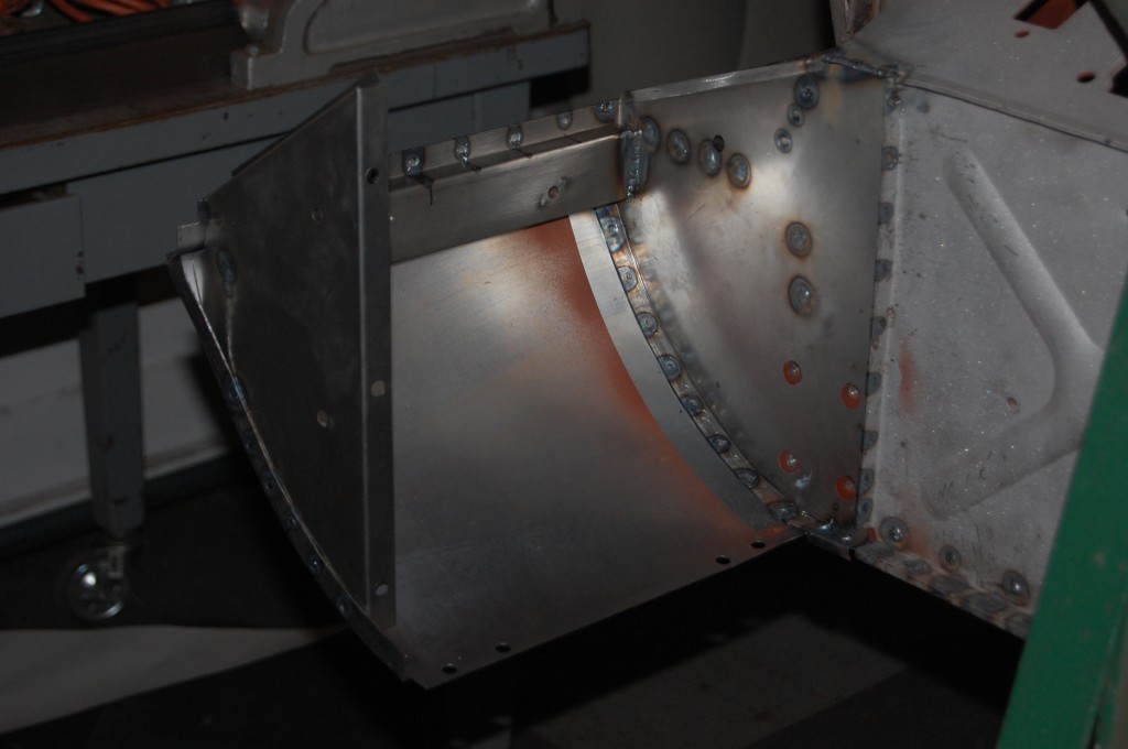

Although there is nothing stopping you from either Spot, or Plug welding the flange of the Sill Closing Panel to the Sill, it was never Stop Welded to the Sill in the factory. A Glue-like sealant, the same as used to glue the attachment strips to the under side of the bonnet, to which the bonnet air ducts were secured, was used.
The following picture, except for the feathered paint edge, is of an unmolested Sill Closing Panel, showing the sealant that has been squeezed out of the joint during original assembly. As far as being welded to the Sill, that only occurred at the horizontal support, in the area indicated by the Red Ellipse.
Whenever you have small, local areas of steel heated to the plastic state and beyond, shrinkage will occur, which translates into distortion that you have to deal with. Accordingly, welding the flange of the closing panel to the sill is not necessary, and bonding this area is the authentic method.

thank you so much for your interesting post. I did not find the information about this assembly with glue anywhere else. The completely complete E Type book is still to be written with all that kind of details.
