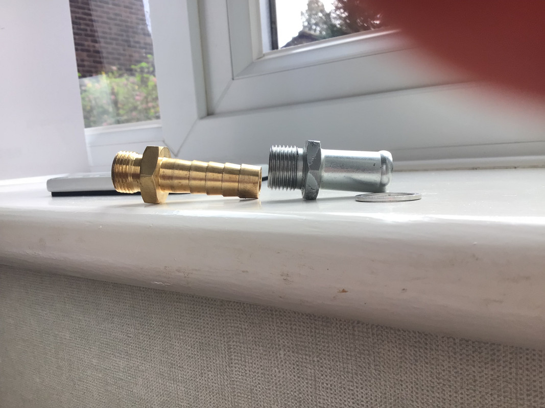

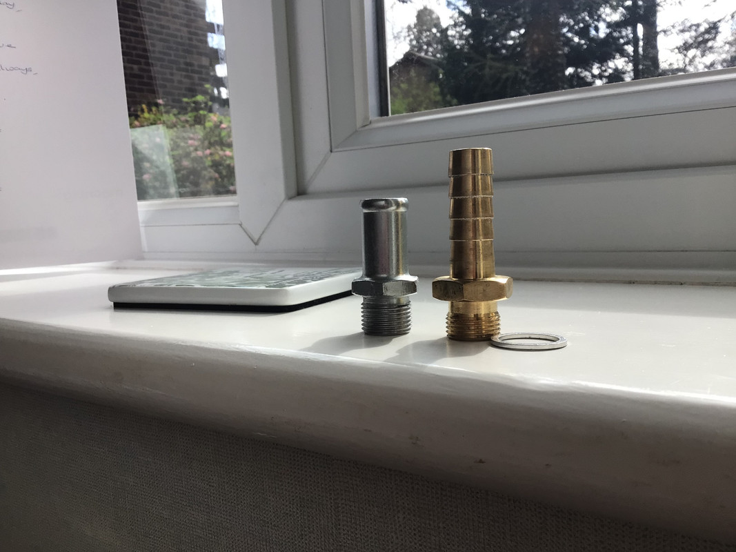

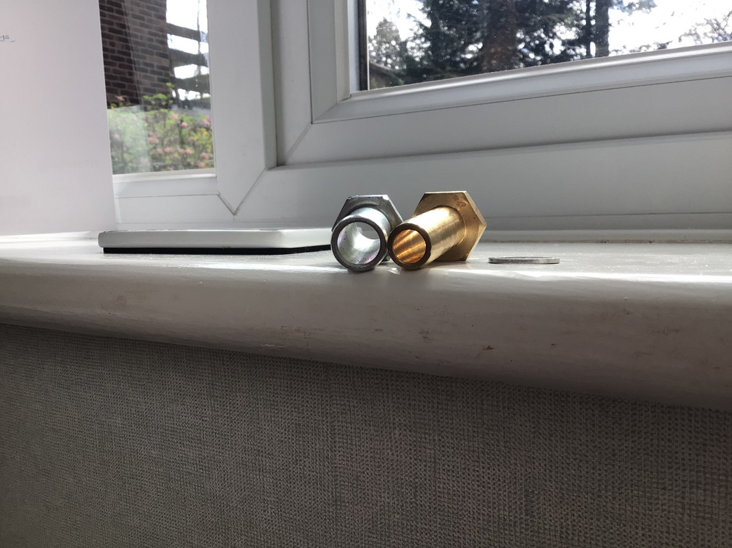

I think that I’ve solved this and at minimal cost. This is what you need to do
Take out the union from the manifold . Hope that the thread is still ok.
The thread is BSPP 3/8 ( pipe thread, parallel )
I bought from eBay a fitting with this thread and a 1/2 inch barbed outlet. Cost about £6.
Thus a simple length of 1/2 inch heater hose does the trick.
No expensive hoses needed, no forcing hose to fit.
Hopefully this will last
Tim

Yes, Tim, that's definitely the way to go ; having the step-down in diameters at the manifold rather than at the bulkhead pipe will make zero difference to the flow through there.
Can you put the Ebay-link up, and a picture of it installed perhaps ?
