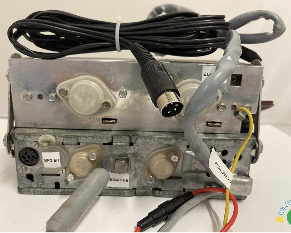

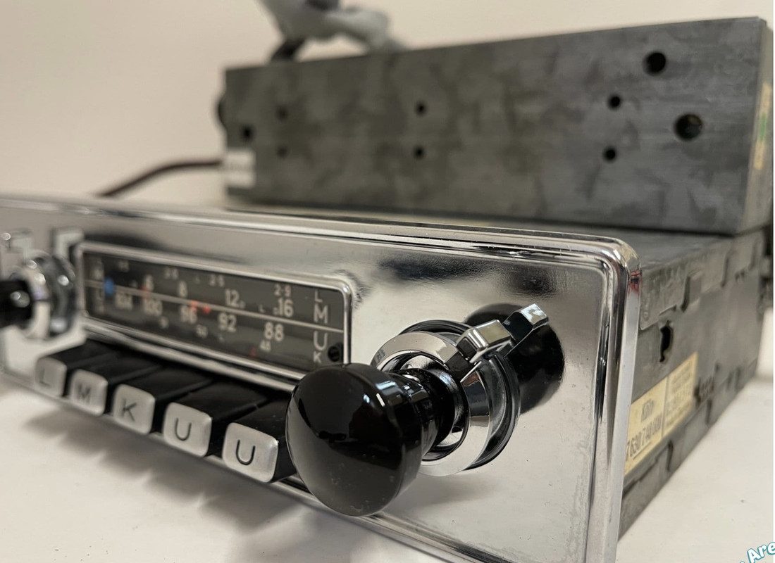

I have achieved this with a Blaupunk Koln and separate amp in my S1 4.2 console. It’s tight and will need slim speakers but manageable. If you have new carpet/under carpet on transmission tunnel, check it doesn’t push the centre console up too far as this is the other area to watch out for. Here’s an example of exactly how I mounted my amp to rear/top or radio. I also have a Bluetooth adapter that fits original Blaupunkt equipment (Black cable on second picture). The fixed brackets in the console will mount to the side of the amp when positioned correctly, this provides stability to the rear of the radio/amp as it does have some weight. Carefully feed wires and cable tie for security. You have room on top of radio, and under ashtray, to store excess cable.

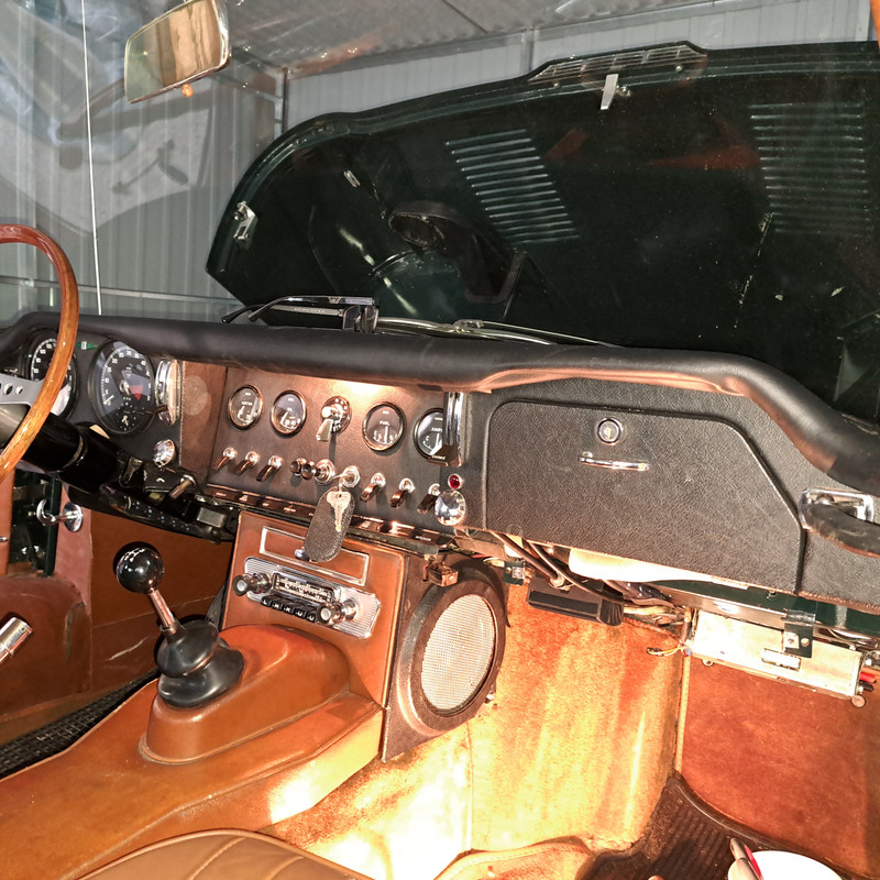

Hi thanks for aswering. I tried to put radio (Frankfurt serie X) and other "back box" inside central console (in every position) but without result. In my case I changed also original one speaker to two speakers. Finally I desisted and installed amplifier box under glover box, It wasn't my prefer solution but it's hidden.
