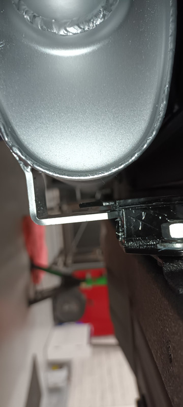

#20 Re: E-Type Fabs / Classic Fabs Exhaust System Price?
Post by Atomlinson275 » Fri Apr 05, 2024 3:23 pm
Just an update on my JLR mild steel silencer that doesn't fit properly -
So I returned the silencer to JLR and they refunded me, no problem. I have retained the JLR mild steel pipes and chromed rear muffler.
So I was hoping to fit the Classic Fabs Stainless steel middle silencer to the JLR pipes but unfortunately they have there own hanging system for the middle silencer assembly which definitely looks to be a vast improvement and allows the assembly to fit really well but is not standard i.e. it doesn't use the standard rubber mounts.
As I am wanting to fit a system as close to stock as possible (hence going the JLR route) I wanted to look elsewhere for a suitable middle silencer assembly.
So after some further investigation I went for the stainless steel Bell silencer assembly. (JLR are the only mild steel suppliers that I could find) This is exactly the same to look at, externally, as the JLR unit but is Stainless steel. When the Bell silencer arrived the plan was to trial fit it and then spray with aluminium colour high temp paint to look like the original which had an aluminised finish.
Guess what? It also didn't fit for the same reasons !! The front and rear pairs of lugs, on the silencer assembly, were slightly closer together, meaning that the front pair of lugs needed spacer washers (no problem). However the rear lugs where still too wide apart such that they cannot slide up inside the corresponding lug on the rubber mount. I think most people/garages ignore this problem and fit it incorrectly with these rear lugs located on the outside of the rubber mounting lugs and add spacers OR bend the lugs up and inboard, meaning the silencer potentially ends up hanging too low. OR just bolt it up without spacers and put stress into the rubber which ultimately looks wrong and is drastically reducing the life of the rubber mounts. Also note that if the silencer lug is on the outside of the rubber mounting lug, you will not be able to get the silencer nicely tucked up between the floor rails as the vertical adjustment is lost.
This appears to be a common problem with all available suppliers of these silencers as I could not find any that had correctly positioned lugs or at least positioned so that they fit up inside the rubber mounts rather than the front being inside and the rear being outside.
To make the Bell units fit nicely within the rubber mounting lugs, I decided to cut off the rear lugs, grind down the horizontal part of the bracket and weld the lugs back on, giving the correct distance apart to fit nicely inside the rubber mounts. (Possibly negating any warranty I may have had!!??)
The only problem with this modification is that the space left between the silencer lug and the silencer body is much reduced, meaning getting the nut in position is tricky. I think looking at photos of original systems as well as watching a great video on Chucks 'Monocoque Metalworks' YouTube channel, that originally the twin silencers were quite a lot narrower than the replacement silencers being made today. This then gives you more space between the lug and the silencer body. Perhaps this is the reason they now have the lugs too far apart?
What I find very hard to believe is that, apart from Classic Fabs, no other exhaust manufacturer makes this middle silencer assembly such that it can be fitted 'off the shelf' as originally intended between the rubber mounts.(Happy to be corrected)
When you consider the Bell stainless steel assembly alone is £400! To have to cut and tig weld the assembly to make it fit properly, is not very satisfactory!! but if they are all like this, we have no choice?
So in conclusion, the JLR silencer assembly part No. C23869, may well be manufactured to the original Jaguar drawings but they don't fit properly as they appear to assume the floor rails, that the rubber mounts are bolted to, are parallel when they are actually converging, as they run to the rear of the car. (i.e. wider at the front than they are at the rear)
I would say that most, if not all, of the other aftermarket silencer suppliers, manufacture the front and rear sets of silencer lugs, the same distance apart? How can they possibly fit properly!
I wonder if perhaps back in 1961 Jaguar, or their subcontractor, built the very first silencer assembly from the original drawings. Then when it was fitted up they discovered it needed the rear lugs to be moved inboard to allow for the floor rails not being parallel. They probably modified it to fit and sent this pattern off for mass production without going back and modifying the drawing.
Thanks very much for taking the time to read this post and I hope that it is of some help and warning to others that if you want to fit a standard silencer assembly 'properly' you will most likely have to cut and weld it!!!
If you go to a garage to have a system fitted, and they don't have the time to modify it, you will probably find that its been fitted wrongly meaning that the rubber mounts will not last very long and that the silencer may be hanging too low under the floor and so prone to being damaged.
I would be happy to hear from anybody who can correct me on any of the above.
I will up load some photos in a following post.
