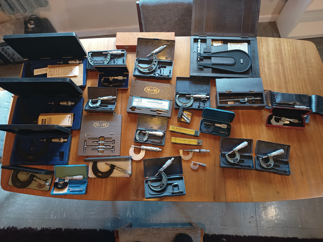

Causes of valve gap measurememt anomalies , part 2.
2.1 Some shims can develop a small indentation from the valve stem. Annoyingly, this little indentation is just a bit smaller than the anvil on my micrometer.
2.2 More than one of the shims I found on my car's engine were a different size than indicated by the mark on the shim. I suspect a PO's mechanic had ground a shim to size rather than replace it.
2.3 I searched through a shim box of a local Jag specialist. Several of his shims were home made and obviously wedge shaped.
2.4 I don't trust shims supplied by the usuals, I always check with my own micrometer.
2.5 I once bought a micrometer on line. Big mistake, it wasn't even close. The next one I bought from a second hand tools and machine tools seller. Since then I have inherited several others....
