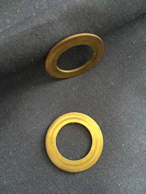

Hi Carsten, thanks for the offer of photos. The only real query I still have is the diameter and thickness of the brass washers that fit between the mechanism and the seat. Are they just 'normal' washers or anything special?

Post by UK Muppet » Sat Apr 06, 2024 12:45 pm
Hi Steve,
My washers were to hand so have taken a photo, 1 inch dia. and 5/8 bore, thickness is somewhere around 30 thou using my micrometer fingers.
Tony
