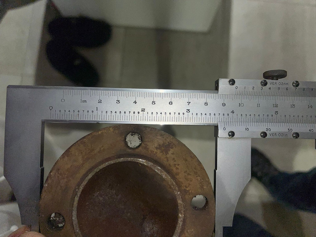

I had fitted the engine and gearbox, so now it was time to fit my new shiny, freshly painted prop shaft. You would have thought this would be an easy quick job. Oh how wrong I was.
The prop shaft flange would not get past the constriction caused by the handbrake recess.
I thought I was going mad as it was so close to going through. I tried every which way but to no avail.
The flange would just not get passed.
I then measured the diameter of the flange and compared it with my knackered old shaft and found that it was 3 mm over on diameter. Quality control - 'Nul Points'
Just to do I final sanity check. I passed my old shaft along the tunnel and it passed without scratching the sides.
So here we go again another instance of aftermarket parts just not quite getting over the line with regard to fit and finish. I really do despair.
I am sure I could have rammed it up the tunnel and forced it through, scratching and damaging the sides of the tunnel and nobody will notice will they!!??
In the end I removed my flanges from the knackered original shaft and fitted them to my new prop shaft.
The next question is whether I now need to get it balanced?
So much for a 5 minute job!

It looks like some half asleep drone working for said "specialist" has rounded 3.75 inches up to 100mm without considering the possible effects. Happens all the time in this game. Our cars were made under the Imperial system, so, please suppliers, stop using metric measurements.
I know it's not the point, but I wonder if it would have fit from the other direction.
Unfortunately, this stuff happens when someone gets hold of a set of Vernier calipers and then think they're an engineer. :banghead:

I would not expect changing the flanges would affect the balance, which is mainly to correct the fabricated shaft. Was the new one sold as having been balanced, are there balance weights?

why not correct or have the diameter corrected on a lathe?
You'd have a better chance of keeping it completely balanced.
If it really is balanced, changing the flange will damage it.

As mentioned above, I would be amazed if by substituting the new for old flange they’d be any difference whatsoever.. or indeed having the new machined to size, what I would be concerned is if it is indeed balanced correctly in the first place, a lot of these parts are what I’d call a starting point, you need (wrongly) to go over them.
Couldn’t you clean/service/balance the old one up and refit?It’ll be awful doing it twice, imo the original is far superior to alot of what’s bought from the usuals..

I wonder if your car has had any transmission tunnel/floor welding done? It is quite easy to weld a tunnel in a bit too narrow.
