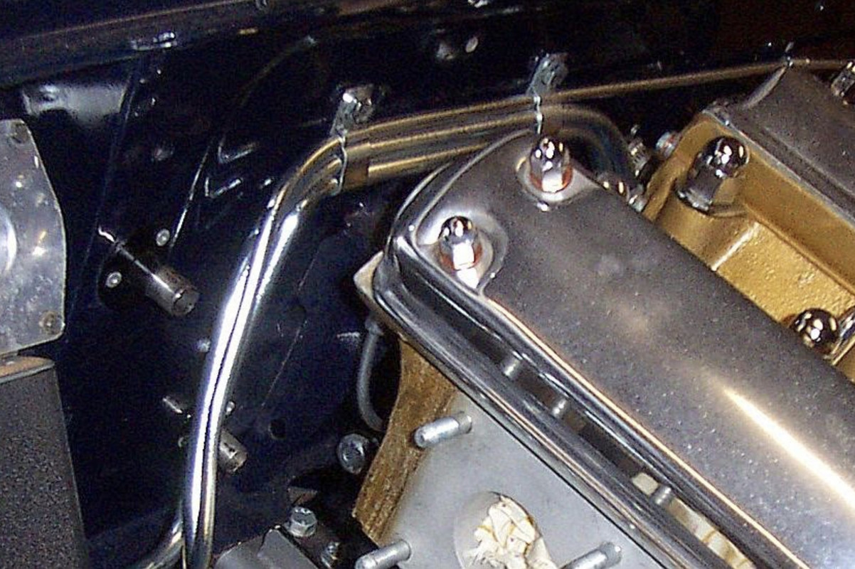

It’s difficult to find photographs of ‘our’ early cars vacuum pipe routing, but here’s a couple to start with:

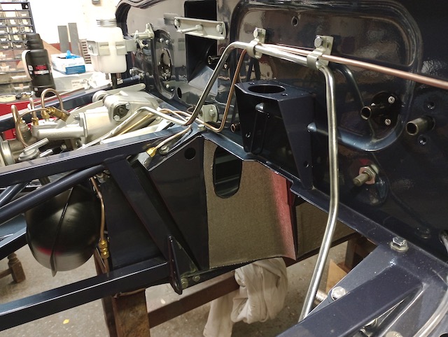

Just checked my car;
The two pipes that come across the bulkhead are together all the way across and as per my previous photos. On my RHD, when they part on drivers side, one continues across and below the wiper motor before a 90° bend takes it down to the T piece and one way valve that then attaches to reservac vacuum tank. This pipe is out side of steering shaft.
The second vacuum pipe, again on drivers side, drops down towards starter motor and inboard (engine block side) of steering shaft. It then turns 90°(now points outbound) and attaches to a flex pipe to the white plastic valve at end of MC. This passes under the steering shaft.
On passenger side, they follow the routing as per photo 1 & 2 before turning 90° in towards brake servo unit and again attached via flexi hoses.

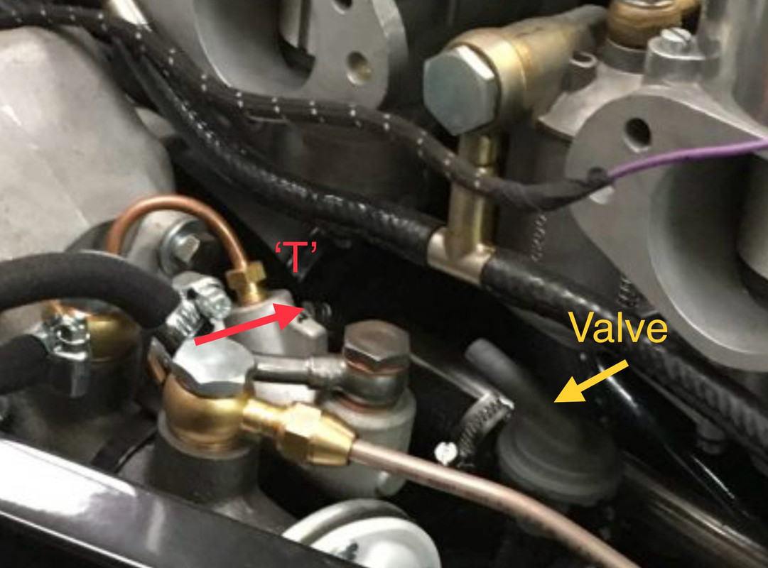

With reference to the ‘T’ junction, near end of metal pipe run. Mine is 9” (23cm) approx. from bulkhead. The T piece is quite close to the Clutch MC (and steering shaft output) but has a small length flexi hose attached that goes to white plastic reaction valve connector. Space is of a premium in that area. I found the following photo for guidance.
Ignore Red lines in this image:

Hi Steve,

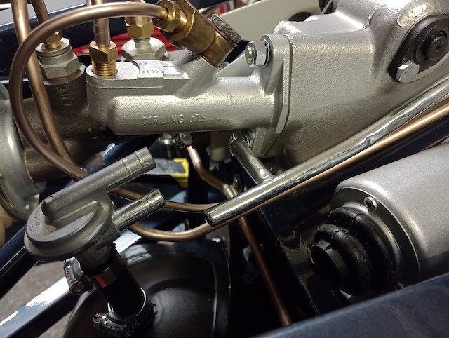

I've checked the dimension to the "T" and in mine its 6in against the 9in of yours which probably explains why I'm having difficulty.
As you can see from the photos of my car (blue) - when the pipe is attached to the firewall with the central clips and with the "T" in a position that will allow the pipe from the rear master cylinder to clear the underside of the clutch master cylinder, the pipe stands off at an angle to the firewall.

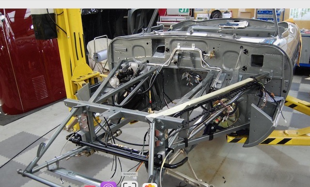

I've also found a web photo (attached) that shows a car with pipes neatly attached to the firewall and hoses to form the connections. Definitely not standard but much tidier.

Small lengths of flex are tricky to get in place in and around the end of the T piece but with engine out you shouldn’t lose too much skin. The bulkhead brackets sit flat with the 3 pipes, one on top of the other, with thinnest ‘fluid’ pipe at top, where the bracket kicks in to take smaller dia pipe.
Your T metal is just touching the lower clutch MC nut, my T flexi hose just touches at same point so you are close. Most (all) pipes seen do sit at an angle off the bulkhead. Note that in your photo #3 (RH side) the distance of first vertical drop to 90° left bend, sits 3” away from bulkhead on my car, other than that, your pipe run looks very similar. Nice colour BTW.
