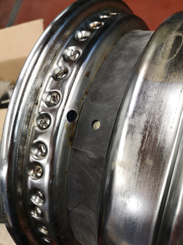

I'm using XVS Michelin 185/80 x 15 tyres with Michelin inner tubes, reference 15 F 13 which is a) the right size, and b) has the oblique-exit valve.
Dougal at Longstone confirmed the tube reference, and confirmed that they did NOT use any tape up on the outer shoulder of the rim, but DID use one in the well in the centre.

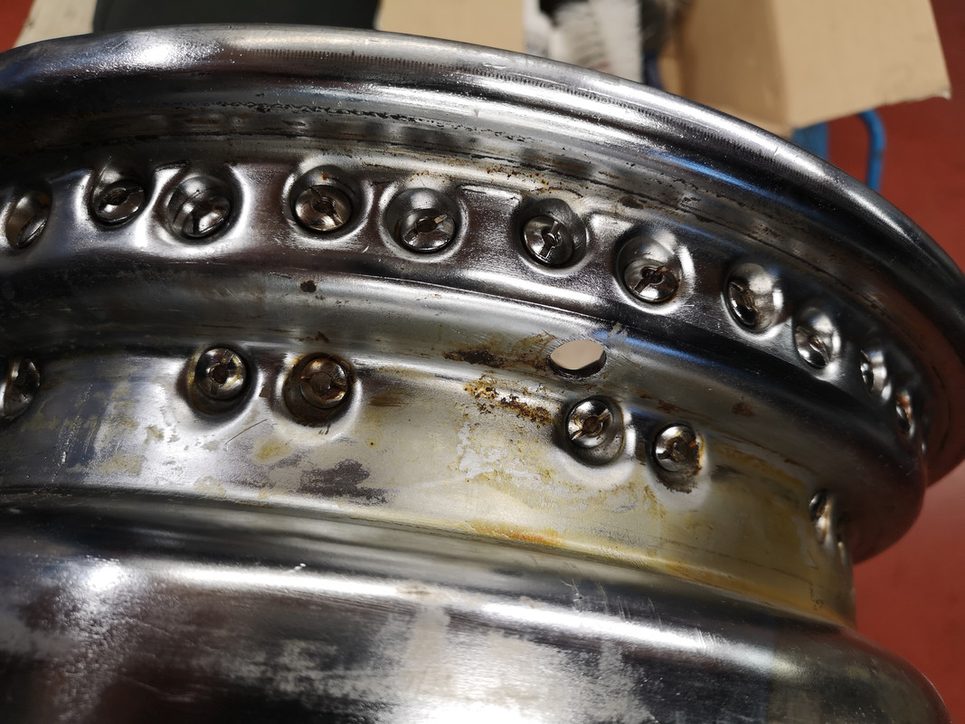

I found Heidenauer 15" x 38mm wide rim-tapes easily enough, BUT in fact the inner well is more like 12" - 13" in diameter so the 15" are way too slack and I will have to find smaller ones.
I'm intrigued by the fact that if there's no rim-tape used on the shoulder, where most of the spoke-heads lie, why bother with one in the wheel-well - where there are so few, especially as the exit-hole for the valve is not protected or cushioned by the rim tape either ?
