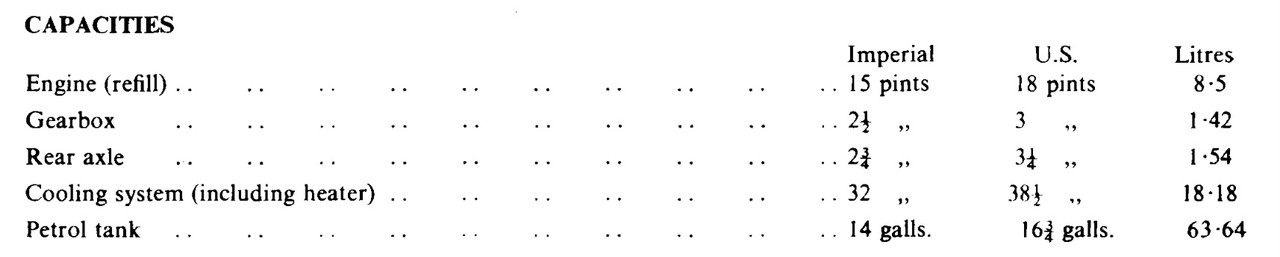

Put back a filter, 8L5 of new oil and then you can ask yourself whether your dipstick is accurate or not. It's understood that if the level is read within the crosshatching, the level is good.

I will get the oil changed and replaced with exactly 8.5l as you suggest so I know how this reads on the dipstick. I'll also have a full service carried out by Moss Jaguar given that the car has just come out of a long slumber to make sure everything is as it should be!
