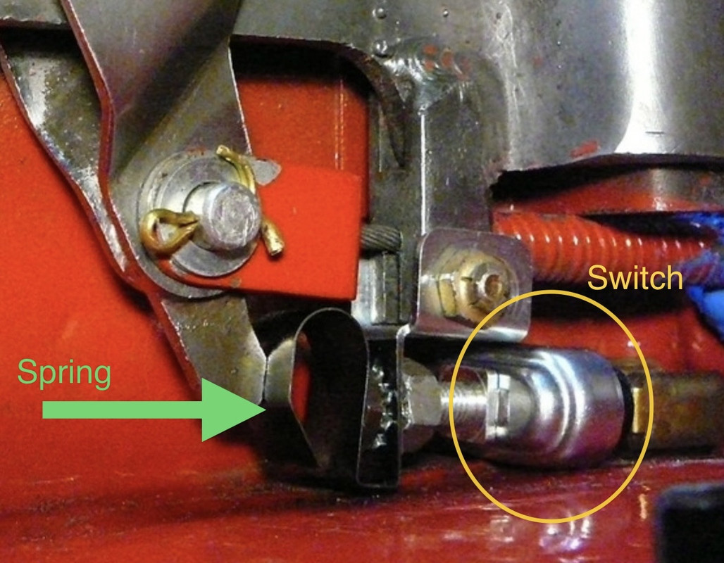

The handbrake light issue can also be caused by a fault with the spring actuator on the handbrake switch, or the switch itself. More likely just the spring, which can be replaced separately from the switch. Does need the console removed to accomplish this, so not a trivial undertaking.

If your Red Warning light remains on after filling brake fluid reservoirs up, go with post #4 (Steve). The clip may be loose or missing/broken or switch maybe faulty. If you suspect the switch, pull wires off rear and briefly touch together (make or break circuit). The Red light should go on and off.
