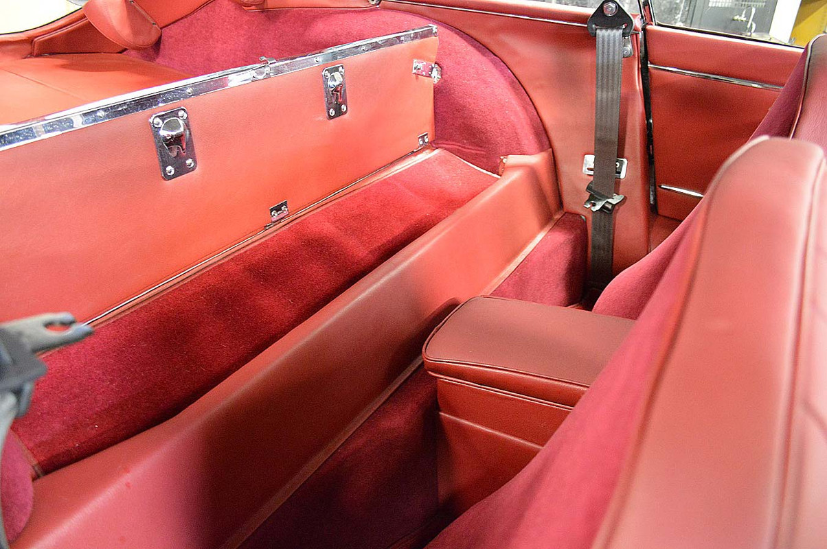

The storage area is lined with carpet at the bottom and the liftable door and front wall are in vinyl.
The cantrail screws are #4 self tappers 1/2" long.

That is true but I found it necessary to trim the tip off a couple of mine where they were threatening to pierce the vinyl.

Here’s a very informative video from BAS International, Minute 17:08 shows Hardura piece for rear storage area liner, also supplied by most UK trimmers.
