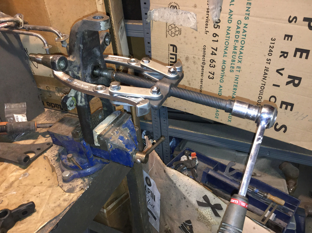

I found this old thread that deals with an issue I am facing at the moment with the front stub axle. As I am disassembling the front suspension in order to clean and replate everything (and change wear parts), I tried to remove the stub axle too. I tried classical methods, e.g. a puller:
but to no avail. I was happy to read that I did not miss something and that it is "mission impossible" in my work shop...
My question to you guys is: do I have to remove the axle anyway? Mine appears ok, no wear, no rust, no pittings. So why should I bother about that, after all? If you see a good reason to do so, thanks to share it.

There is no reason to remove the stub axel if there is no wear....useing the puller isn't a good idea...put the nut back on the stub axel and use a press....leaving the nut on stops you damaging the thread but more important is that without the nut the stub axel will fly out of the carrier and could cause serious damage...Steve

When I disassembled my front uprights for plating (You do not want to plate the stub axle) I used a press, lightly loaded, then applied heat to the upright center with a heat gun. Took just a few minutes for the stub axle to pop loose. Have something soft to catch the axle when it shoots out!

Thank you Steve & Steve for your answers.
I'll try and go on without dismounting the axle from the carrier, and clean & zinc plate the later with the former on. I will protect the axle first as a matter of course.
