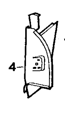

#9 Re: Help : Stripped Captive Nuts on door hinge fixing bolts
I see I was banging on about this a while ago
I'm intrigued by the fact that the J30 parts book makes no mention of these captive nuts, and if it were possible to get the correct size (the square) I'd rather use those than adapt stuff that will doubtlessly work but may not be as snug a fit in the cage.
Originally I believe too that they were made of particularly good steel, to make sure the bolt shed its threads before the inaccessible nut did.
Not that I need them, but for example the oblong threaded plates that behave like a pair of nuts on the door-to-hinge fasteners, are they listed somewhere too ?
Can't see anything in J30 ...........
#10 Re: Help : Stripped Captive Nuts on door hinge fixing bolts
That is because it is an "assembly", in this case 'Shut Pillar Assembly'. A composition of parts hence no individual part numbers.
