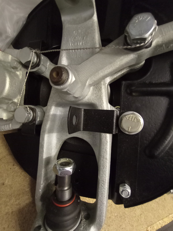

Post by AshM » Wed Jun 26, 2024 1:42 pm
Here you go Philippe.
You should definitely ensure you have the correct strength bolts and they must be wired.
Series 2 FHC 1970
1R 20607
Posts: 560
Location: Omaha, NE area
#6 Re: Front brakes safety wiring
Post by bitsobrits » Wed Jun 26, 2024 6:08 pm
It's only the caliper bolts that need wired, and AshM provides an excellent example of how to do so.

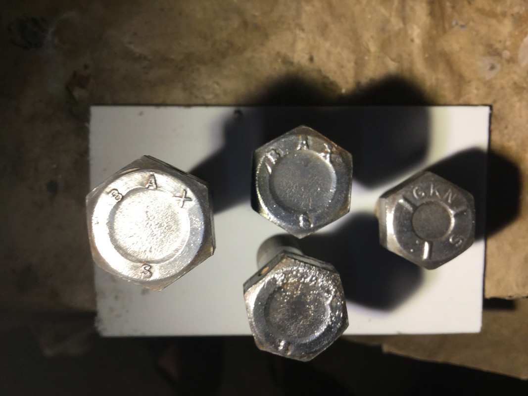

#7 Re: Front brakes safety wiring
Post by Philippe-J. » Thu Jun 27, 2024 9:27 am
Thank you all for the wiring explanations.
Now, about my bolt strength grade. I took a photo of them:
3 are from BAX, the 4th and shorter is GKN, all are S or "'5" graded. As far as I can see on the photo of SNG's listing, this is correct (though it is quite odd that this spec is not clearly written for such a key item). Can you confirm this is the correct grade to secure the brake calipers?
Regards.
Philippe-J

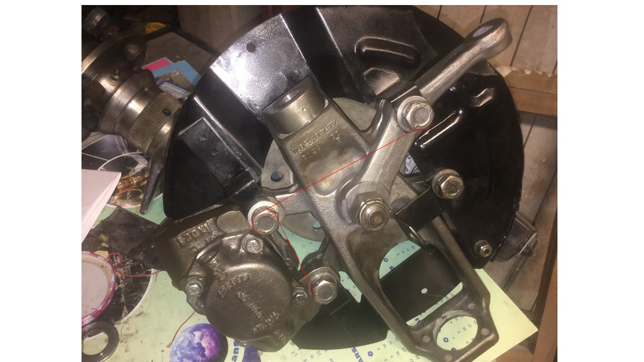

#8 Re: Front brakes safety wiring
Post by Philippe-J. » Mon Jul 08, 2024 8:27 am
Finally the rationale for the front brake safety wiring is quite obvious when looking at the inner side of the hub carrier:
The RHS lower bolt (on the image) does not hold anything but the brake mud shield (black), so it does not need to be wired. That's why it has no hole in its head on my car. The two LHS bolts secure the caliper, and the upper RHS secures the steering arm. That's why they do need to be wired, following the red lines above, even if they have spring washers under their heads.
It sounds all logical, doesn't it?
Philippe-J
Posts: 8981
#9 Re: Front brakes safety wiring
Post by mgcjag » Mon Jul 08, 2024 8:33 am
Yes...correct..Steve

#10 Re: Front brakes safety wiring
Post by Phil P » Mon Jul 08, 2024 6:51 pm
Forth bolt is not safety wired.
Has anyone experienced spreading of the fork attachments of the brake shields?
I found that the forks were spreading and ended up with the washers cupped. I solved it by using high tensile washers.... seen as dark grey in the photo.
Phil P

#11 Re: Front brakes safety wiring
Post by Philippe-J. » Tue Jul 09, 2024 7:47 am
As a matter of fact I found the forks slightly spread when I dismounted my car. Nothing serious but your solution seems to be on the safe side. Where did you get those high tensile washers?
BTW thanks for your photo, it clearly illustrates the proper safety wiring of the 3 bolts.
Philippe
