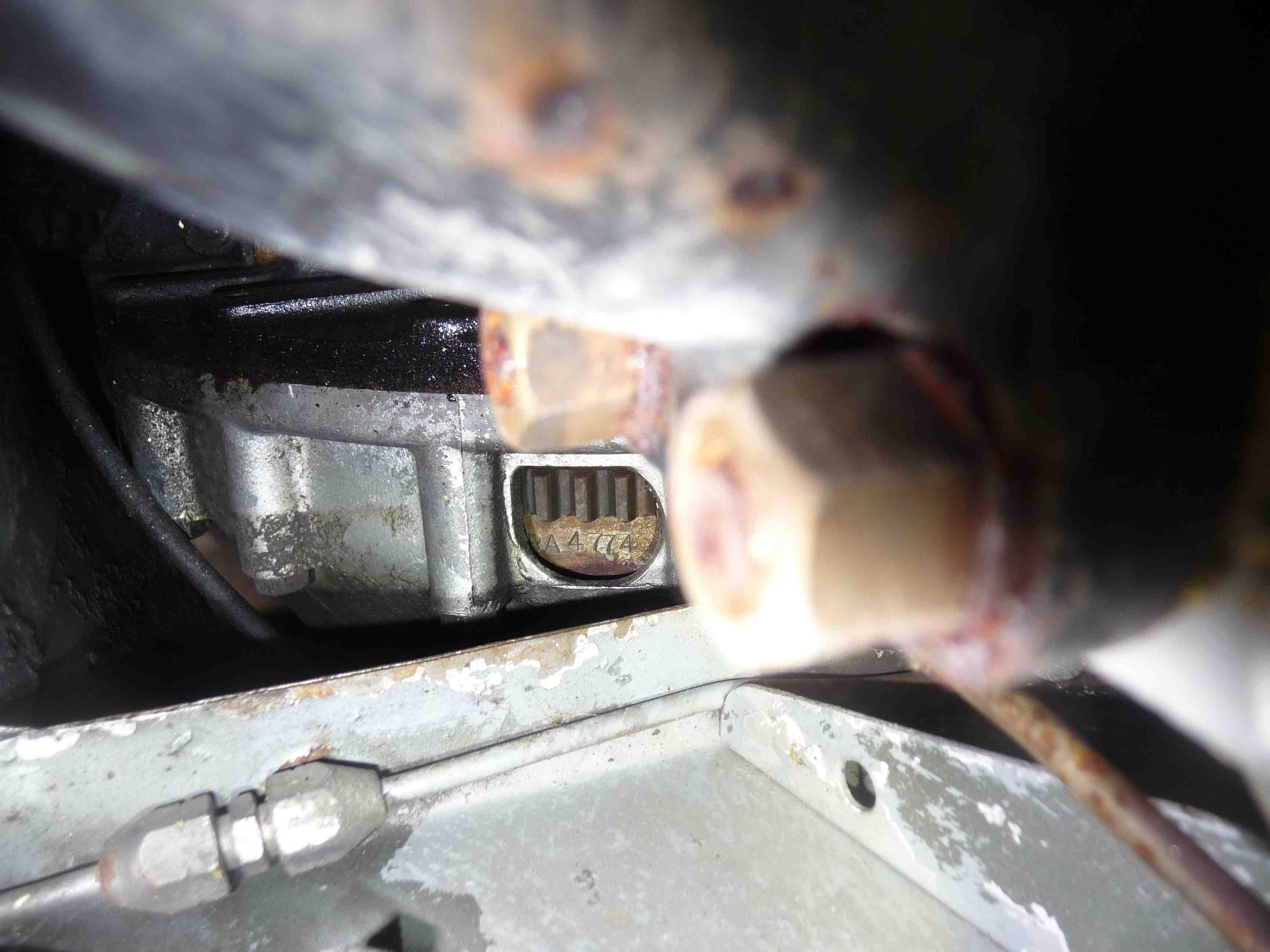

My 3.8 FHC has had fitted by the previous owner such a hight torque starter from Powerlite (positive ground) sourced from SNGB before 2012.
Up to now there was nos starting issues but I confess that I did not check for any positioning issues except that the flywheel teeth look normal (picture here under also showing engine number on the flywheel):
Could it be that there was an evolution in the design or that such a starter has no issue on 3.8 engines?

Hi Serge in my first post I specifically mentioned 4.2...I havent checked 3.8....3.8 use a different starter and the bellhouseing and flywheel are different and i dont think there is a spacer like in the 4.2 cars....but as per any modification measure and check is the best option..Steve
