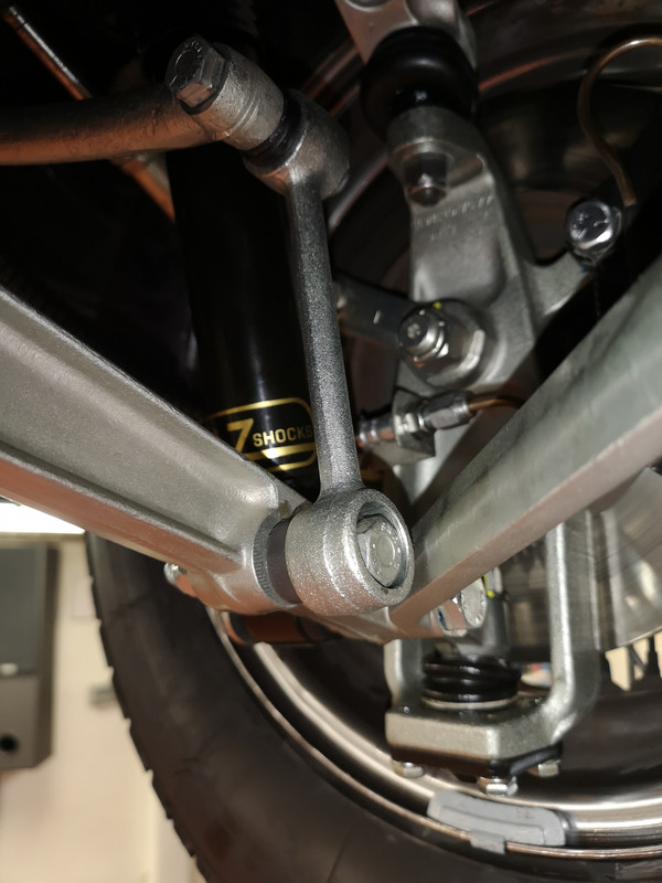

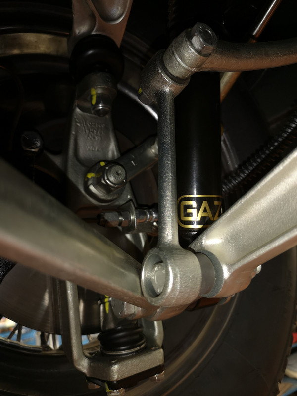

After just 20km one of my top front ones slipped out, leaving the top of the dog-bone waving in the air.
I had the bolts through the other way, with the nut and washer against the roll-bar rather than against the dog-bone, not like the picture as I've now refitted them.
I had a packet of 4 new ones, both the ones on the car and these spares will have been from SNGB, and they all look the same.
But re-fitting it required just a squeeze with an adjustable pipe-wrench, in-situ on the car, whereas it seems to me I used to have to fit these with a small press or at the very least with careful use of spacers and a long bolt as a puller.
As things now stand, the dog-bones are going to slide one way until they hit the roll-bar, or the other way until they hit the washer - and I'm not even sure that's bigger than the bore of the dog-bone.
Anyone else had this, and what did you do ?
As things stand, of course, there's nothing to stop the bottom ones sliding out as well ......
Now I think about it, I would have tightened these on full-droop ; maybe it would help if they were tightened at mid-height, like the wishbone pivots ?
