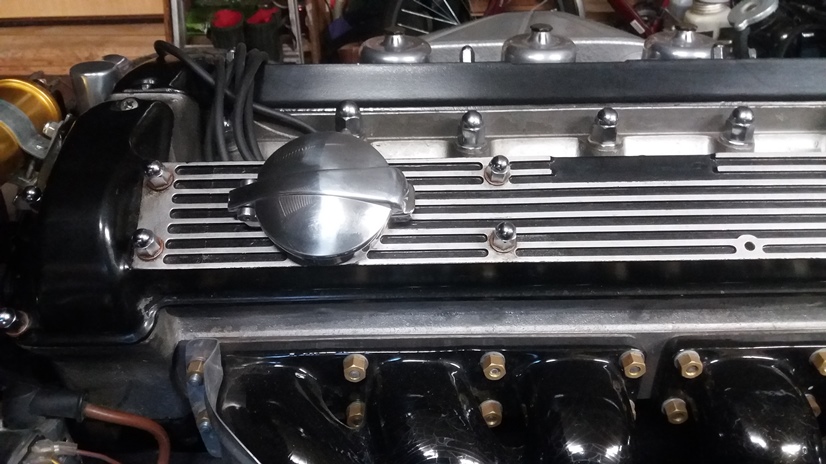

#6 Re: e type oil filler cap rubber seal 3.8 series 1 1963
Post by JerryL770 » Sun Jul 28, 2024 10:26 am
I fitted a Monza type cap on mine, precisely because of the torque needed to remove the screw cap, which my old hands could not achieve.
