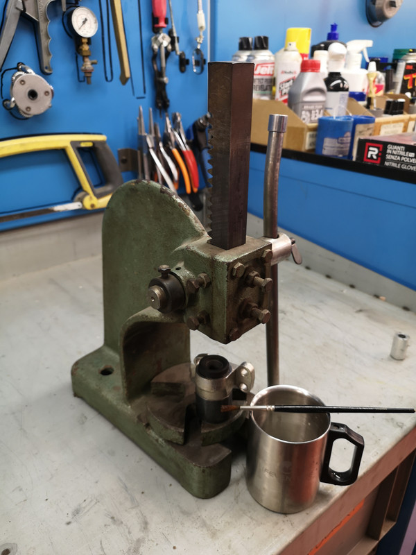

#7 Re: Upper Fulcrum Shaft Bushes C8672 - Sloppy Bores ?
You have to hand it to SNGB, sometimes .......... I ordered their standard bushes on Thursday morning and had them fitted by Friday lunchtime, UPS delivery direct from their depot in Holland.
They look well-made, and the bores - cleanly machined - are a snug fit on the shafts.
Anyone short of ideas for their X-mas present should leave a picture of one of these lying around, brilliant piece of kit.
Plus, when things need a jerk, a copper hammer on the crown does the trick.

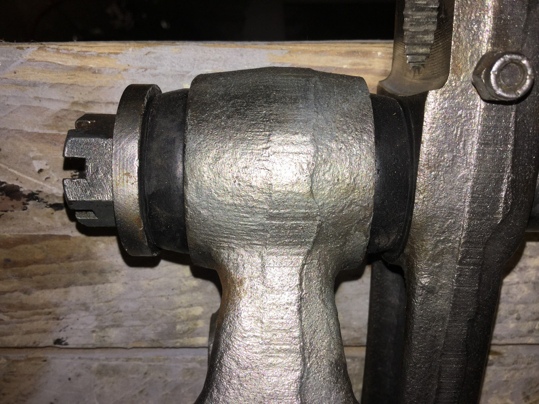

#8 Re: Upper Fulcrum Shaft Bushes C8672 - Sloppy Bores ?
Hi Rory,
this shot of a bush fitted in a block had me interested as it illustrates the concern I am facing at the moment.
As with mines the rubber got over the inner bore when it was squeezed into the block, by +/- 2 mm.
Can you then achieve that the washers be in contact with the inner metallic bore of the bushes when you tight the slotted nut on the shaft (according to workshop manual page J.10)?
I explained my problem in another thread by I jump to yours as you are at this very stage yourself.
Thanks for your explanations.

#9 Re: Upper Fulcrum Shaft Bushes C8672 - Sloppy Bores ?
Salut Philippe,
The rubber is deliberately longer than it's interior sleeve, so that tightening the nut crushes the excess, increasing its diameter, so that you effectively end up with a stepped or H shaped rubber, whose shoulders act to keep the bush centered in the block.
Tightening up the nuts is therefore not difficult, and the crushing effect is normal.
Good luck.
Good luck.

#11 Re: Upper Fulcrum Shaft Bushes C8672 - Sloppy Bores ?
"Tightening up the nuts is therefore not difficult"
--> you must be very strong! I have the feeling that the excess rubber is too thick to allow the nut tightening to push the washer into contact with the inner sleeve. Or even to just clear the hole in the shaft for the split pin...
I measured a lower sleeve length of ~ 46.9 mm when the length of the rubber in the block is 52.3 mm. So I have to crush 5.4 mm of rubber, which I find quite big.
Or should a certain shoulder of rubber remain also between the washer and the sleeve, contrary to the figure in the workshop manual?
Steve: I am aware that I should tight all the suspension only under full weigh of the car, which is far away in my future

#13 Re: Upper Fulcrum Shaft Bushes C8672 - Sloppy Bores ?
Steve,
these are lower wishbone bushes (C8673) and, in a lesser way, upper wishbone bushes (C8672). I had them from SNG, in the standard option.
Here is a shot of one of them in situation:
You can see that the rubber bead is quite thick
Regards.
Regards.
#14 Re: Upper Fulcrum Shaft Bushes C8672 - Sloppy Bores ?
Looks normal to me......Steve

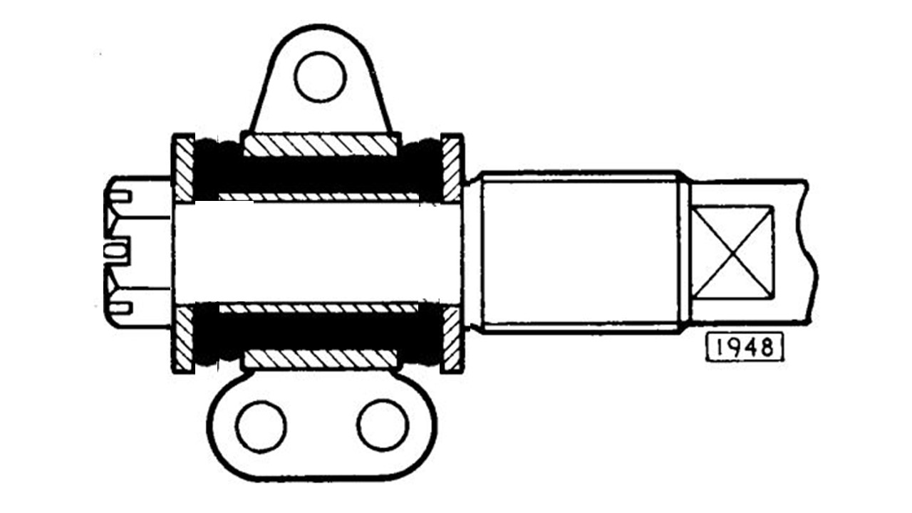

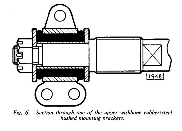

#15 Re: Upper Fulcrum Shaft Bushes C8672 - Sloppy Bores ?
Hi Philippe-J,
The objective of the bush is to isolate suspension from the frame and provide compliance during movement of the suspension arms. There has to be an amount of rubber between the washers and the fulcrum block/frame mount otherwise there would be no isolation.
The section Fig. 6 is not contrary to what you have in the picture but describes it exactly.
Yours,
Yours,

#17 Re: Upper Fulcrum Shaft Bushes C8672 - Sloppy Bores ?
Thank you all for your responses.
Just to make it clear, you confirm that the following situation:
must be avoided?
That's the situation I dread when I see how thick my rubber beads are and reluctant to being crushed under slotted nut tightening
must be avoided?
