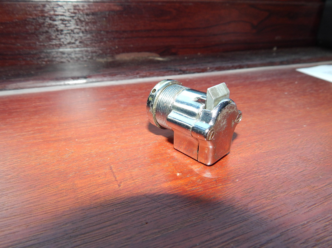

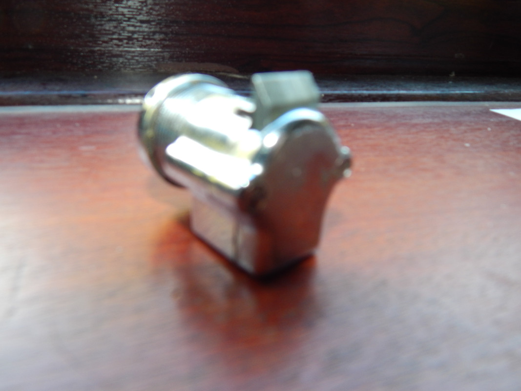

Posts: 411
#5 Re: Glove box lid lock.
Post by Bob. » Thu Oct 10, 2024 1:19 pm
These might help
Bob

Can I add a comment to go with Bob's pictures.
I spent quite a while trying to figure out what hd happened to my glovebox lock that was not working and how to reassemble it. Having found Bob's pictures it suddenly became clear as to what order and how to put it back together, but at first I did miss one relevant point.
In picture one there I did not pick up that both the sring (closed part) and the roller partr of the catch both go into the oblong hole of the long bar part of the mechanism. If you look at the picture you will see what I am referring to although I had missed the way these parts fitted together.
To insert both parts I found it easier to lay the bar over the roller -part of the catch and then using a tin tool like a paint scraper or Stanley knife blade, it was easy to slide the spring into the slot. So I hope this hellps others
