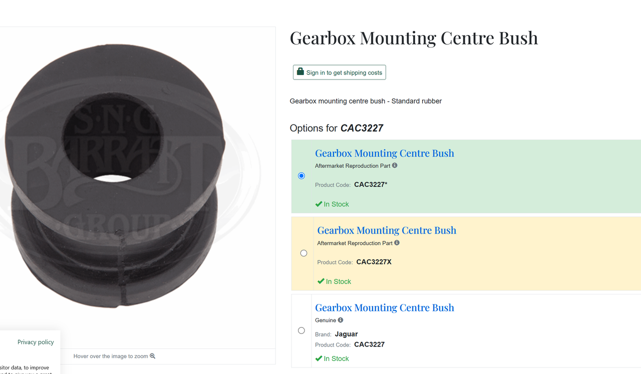

Do you have the rubber bush missing between the gearbox mount and the gearbox cross member?

Thanks - I don’t think the bush is missing or the locking pin left in, but will check. Thanks.
