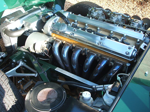

I've run Webers on several different cars, (have them on 3 at the moment) but not on E types so can't help you with specifics there. But if Webers are unhappy, they most likely have not been properly jetted for the particular specification of the engine. Also, the advance curve will need optimized (generally speaking more initial advance with total advance remaining the same-i.e. a recurve of the distributor is required or something like a 123+ignition), and the manifolds need be working with the carbs, not against them.
On this last item, there is a popular manifold option out there for E-types with three tubes going into a wide fan shaped collector then into a single down pipe which is famous for causing a mid range flat spot (2000-2500 RPM). My conjecture, based on a simple flow test (mimicked the test I saw on ClassicFabs site), is that the fan shaped collector tends to cause reversion issues as opposed to the desirable scavenging effect of a more normal tightly grouped collector. No carbs like reversion pulses, but Webers seem to get especially cranky when this happens.
What I'm certain of is that changing the fan type collector manifolds out for a set of long tube manifolds with a proper collector (ClassicFabs) transformed my E type (running SU's) into a crisp, no flat spot revver without any other changes. Experience with Webers/Dellorto/Solex on Lotus TCs, Porsche, and most recently a Ferrari V-8 helped me to understand that unwisely chosen exhausts can impact the vacuum signal 'seen' by the carbs, requiring jetting changes and/or exhaust design or pipe diameter changes.
The engine being basically an air pump, anything you do to change the airflow through the 'system' will require changes to jets and air correctors when running Webers. Much more complicated than SU's in this regard. Personally I'm a big fan of the crisp throttle response and marvelous sound of properly set up Webers, and if you are willing to dive in and learn about setting them up they can be very rewarding, and not very expensive to get right. But if you are going to rely on a shop that is most likely not truly experienced in the intricacies of Weber idle/transition/main and starting circuits (and therefore bills many hours) I would suggest a conversion back to SU's for simplicity and cost management.

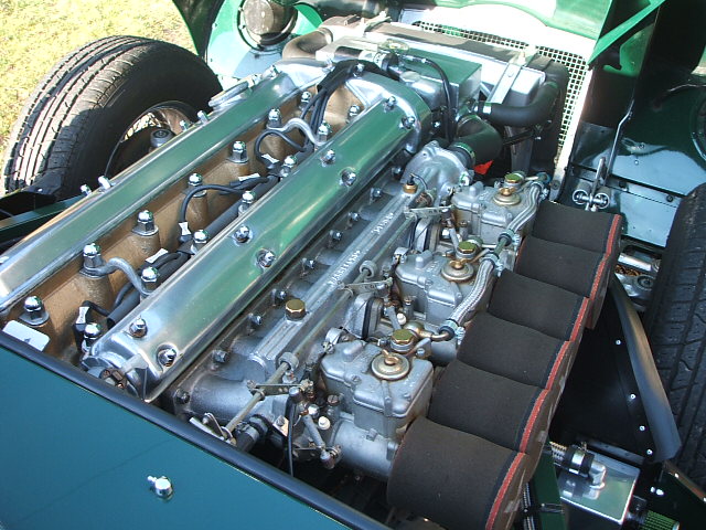

Just to confirm, I have run triple Webers on my E Type for over 25 years and have done many miles including European trips such as down to Monaco and to Italy with them. They are Italian 45DCOE152 Webers, with 3 progression holes running through Pipercross foam socks sitting on 2.5 inch ram pipes. They have plastic floats set at 12mm. The engine breather runs down to an alloy catch tank under the Webers.
I run a stock SU electronic fuel pump and stock distributor but running Lumenition electronic ignition. I have a Hayward and Scott large bore stainless exhaust system including their headers.
The only difference to all the settings to those shown in Andrew’s post #3 is that I changed the main jets from the recommended 1.65 to 1.70. I did recently - last year - have a starting issue and misfire on idle which was resolved by fitting new inlet needle valves (size 200) as the original ones had worn a witness mark.
Hope this helps.
