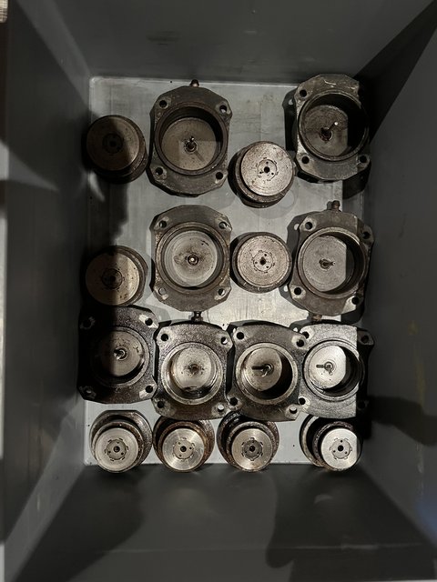

They’ll be sand blasted, plated, and sleeved with
Inox sleeve

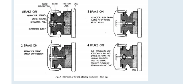

My question is about this système :

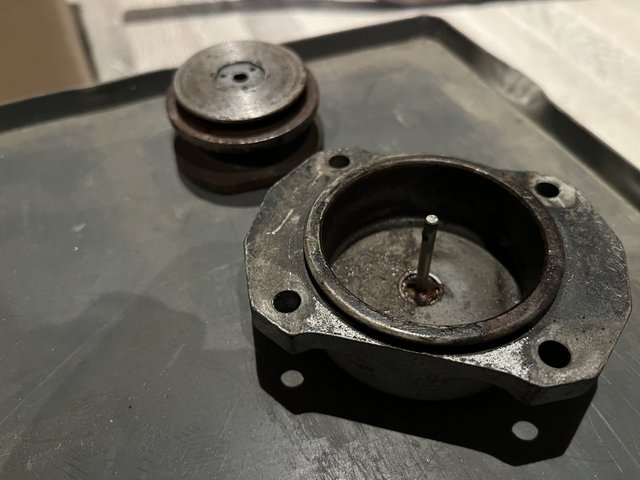

All the pins are very difficult to introduice in the piston hole,
So, is it inerresting and secure to cut the pin or drill the hole to stop the systeme ?
