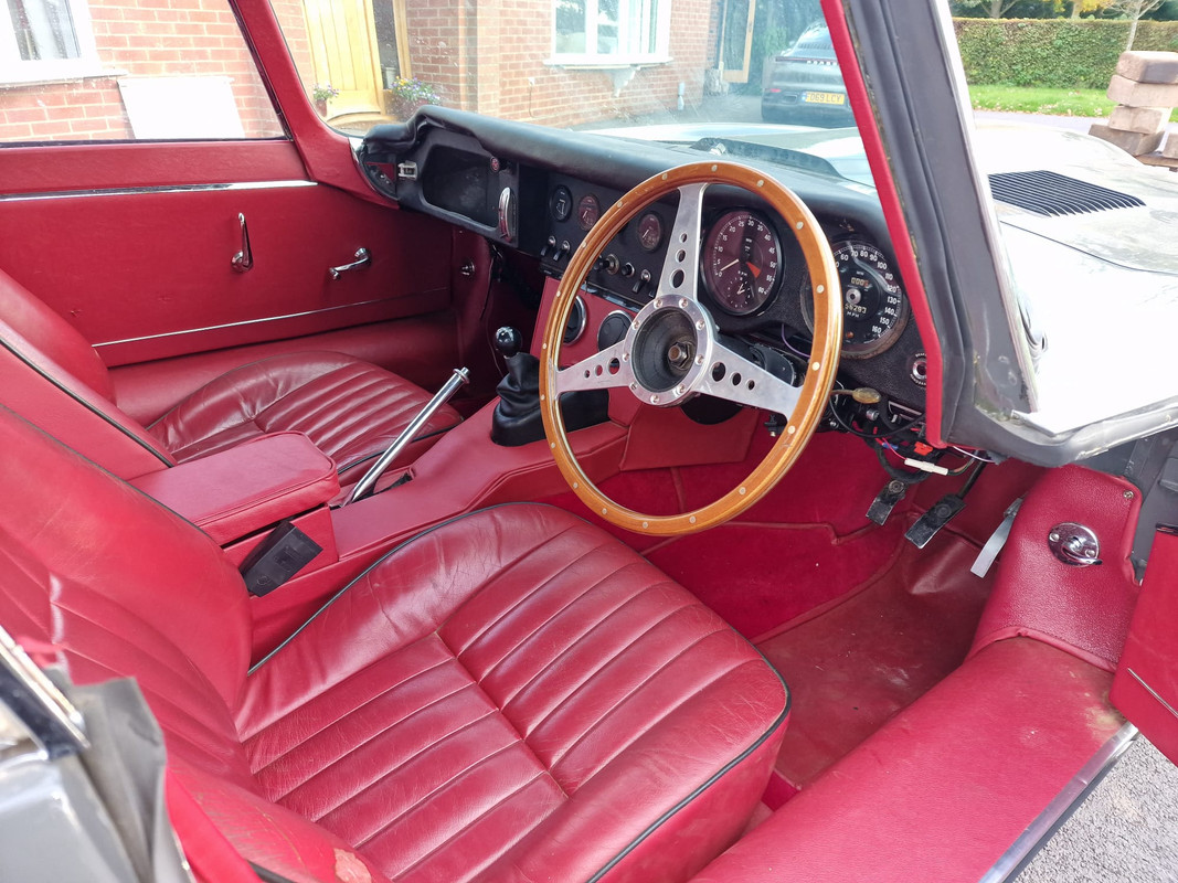

I have fitted these.
How easy it is depends on whether you want them to slide or not.
I need the maximum leg room as a driver so I just bolted them in as far back as possible.
Not bothered about the passenger being able to slide, so I fitted them in a fixed position too.
Then its easy,
The MGF seat base lifts out, so you can put the baseless seat in to do you measurements.
I think all it needed was 4 flat plates of steel per seat, drilled in the correct locations.
Then once fitted the base slides back into position.
The red leather ones are a dead ringer for Jaguar red leather too.
The seat base fitted between the cross-member and the rear bulkhead nicely.
Here they are in a car close to being finished.

#3 Re: MGF MGTF seats
Many thanks for that and the photos. They certainly look as though they belong. As you say, the colour match is excellent.

#4 Re: MGF MGTF seats
Thanks.
Yes, they are great apart from no adjustment. Not a problem for me, but could be for someone a bit shorter.
At 6ft a SWB E type Coupe is about on the limit of adjustment for me anyway-as a car!
I find the roadsters much easier to get in and out of (with the roof down).
I completely removed the sliders to get the seat base as low as possible too.
Thats the only way I could avoid hitting by head on the ceiling and squeezing by legs between the steering wheel and the seat.
Doing it like that made it nice and easy to do though as you can see the floor of the car with the seat in place and the base removed for measurements. There is definitely very little wiggle room once you lift the seat into position.
I think I paid £50 for a pair of low mileage red seats. The guy I bought them from couldn't believe where they were heading.
It would have been in the region of £3k to find and fit a pair of S1 4.2 recliners. Mine were too far gone.
New seat covers alone are now around £900 a pair. Foams, clips and diaphragms another £500. Seat frames are hard to come by and sliders (which I never use) another £250 for 2 pairs.
The MGF seats are excellent for me. Very comfortable.
Not sure I would want to change them now even though its reversible.
