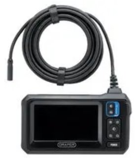

Invest in a boroscope, it may save you a fortune in the long run. I used mine to check the release bearing gap post clutch slave cylinder & push rod change out & adjustment. There’s plenty of room for one.
