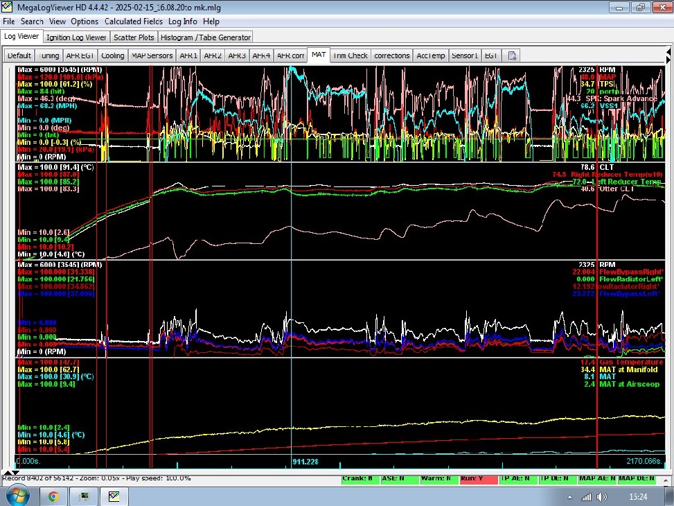

Here are some experiences with my v12.
It'll take up to 10 minutes to just get water hot enough for the thermostats to open. (2nd graph, white trace)
The engine bay temperature will start to stabilise after about 10-15 minutes. (4th graph, yellow trace)
So drive around for at least 15-20 minutes. The graph shown is from t=0 to about t=35mins
The 4th graph, yellow trace is from an air temperature sensor mounted to the metal inlet manifold on the engine block, so reflects air flow inside but also heat being dissipated from the block into the manifold. It doesn't show any drops until after 18 minutes, so you'd guess the cylinder block is still warming up until then.
