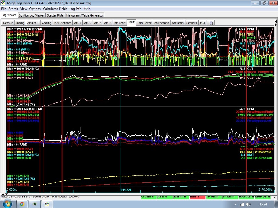

Here are some experiences with my v12.
It'll take up to 10 minutes to just get water hot enough for the thermostats to open. (2nd graph, white trace)
The engine bay temperature will start to stabilise after about 10-15 minutes. (4th graph, yellow trace)
So drive around for at least 15-20 minutes. The graph shown is from t=0 to about t=35mins
The 4th graph, yellow trace is from an air temperature sensor mounted to the metal inlet manifold on the engine block, so reflects air flow inside but also heat being dissipated from the block into the manifold. It doesn't show any drops until after 18 minutes, so you'd guess the cylinder block is still warming up until then.

I think the 15 to 20 minute suggestion is definitely in the ball park. I have recently changed my daily driver for one that has a digital oil temperature readout. I didn't realise how much I would refer to it until I started using the car regularly. I'm sure that not all cars will be the same but mine seems to stabilise at around 101C after around 20 minutes of A road driving at 50 to 60mph.
