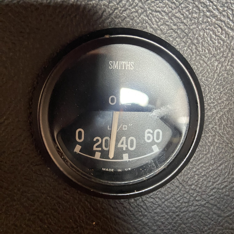

I have been struggling with low oil pressure getting 15-18psi on idle and 30-35psi at 2,500 rpm when hot. If I remove the OPRV hose and run the engine on idle, hot or cold, oil gushes out of the OPRV (into a container). This suggested to me that the OPRV was opening well below 20psi so I put a new spring and valve in and there was no difference. Next I removed the oil filter housing and had the valve seat machined by about 0.5 mm and replaced it all along with a new gasket (the right way round) - still no difference, oil was gushing out of the OPRV on idle!
It has always been like this since I purchased the car not that long ago and the previous owner sugested that it had always been like this and that it was just the dial giving a low reading. The engine was rebuilt in 2011 with new bearings and oil pump etc and has done less than 8,000 miles since.
Am I right in assuming that if oil is exiting the OPRV in this way, it must be faulty or is there another cause?
I am a bit lost as to what to do next, any suggestions would be very much appreciated.

#2 Re: Oil Pressure Relief Valve Problem
First thing to do is test oil pressure with a wet guage
The electrical senders and guages are notorious for incorrect readings...you could take off the filter houseing and have a good look at it...is it correct.....has it been damaged modified....test the valve opening pressure with compressed air...Steve

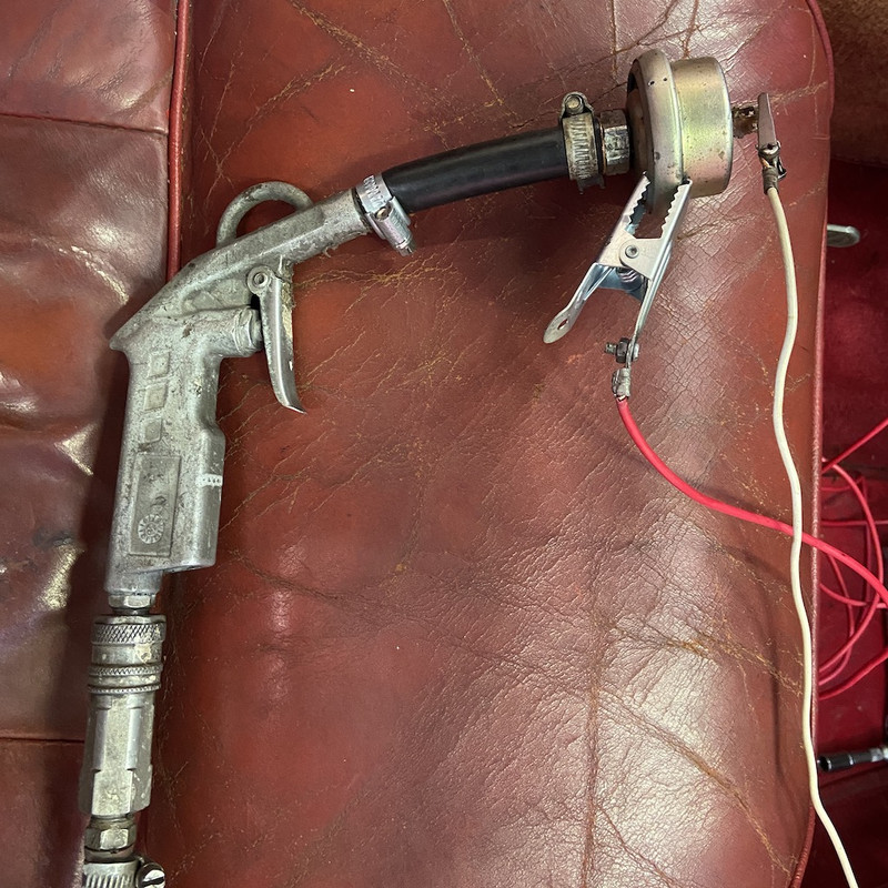

I decided to check my sender and guage with compressed air so I connected my air line to the sender unit and gave it exactly 60psi after connecting it via an extension wire and an earth. The results were no different to when the engine was running at around 2,500rpm hot, around 28psi. If I increased it to 80psi the result was the same.
This to me suggested it was the gauge and or sender at fault
Air line feed to the sender unit set up
28psi reading when the air pressure was either 60psi or 80psi

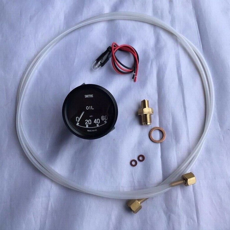

I have now fitted a mechanical guage from Quality Classics in Ludlow for £175. Great bit of kit looks very similar to the original, was fairly easy to fit and is now giving me an accurate reading, 30psi at idle and 55psi at 2,500 rpm when hot.
New mechanical oil pressure gauge and sender from Classic Quality in Ludlow
