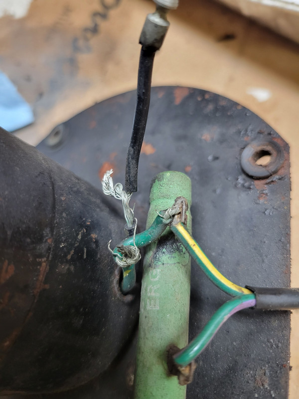

Old thread but I thought I'd post in case it helps anyone in the future. I recently discovered some badly hacked wiring on my blower motor, see pic. I removed the motor to fix that and measured the resistance while at it. Mine is 2.5 Ohms, and the (working) motor is 1.7 Ohms.
