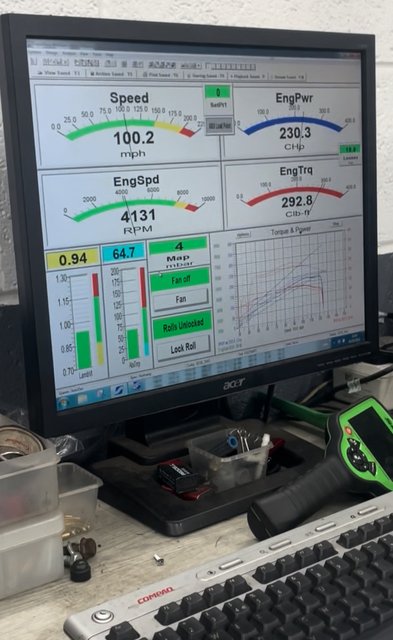

For clarity and future reference here it is at 100mph 4100 rpm, 292 ft torque, on the rollers at Northampton motorsport. That’s about as accurate as it gets I would think, flat out at 5500 we were at 137mph.
(The calculator you posted above had me at 145mph at 5500 rpm)
As mentioned thats a std 4 speed with a 3.07.
