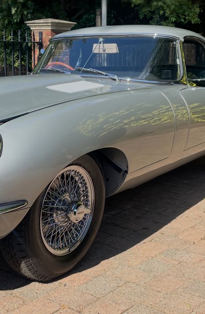

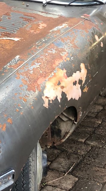

Agree with Geoff whole heartedly, repair your original take it back to bare metal and any rust pitting coat with fertan leave to dry 24 hrs, then after a light sand a good epoxy primer before using your fillers..
3 years later no rust.. on original knackered wings, see pics below before n after.
If it’s rotten to where the wire forms the wheel arch, then simply remove all the metal but leave the wire in place, and replace with new metal, then trim your new metal back to the wire leaving 5mm overhang, little heat and hammer n dolly it over gently, will be as good as new with a bit of lead on the outer panel (fillers today very good as well) just need the inside edge as it folds over looking neat, a 36 grit fibre disk helps here.. save a good 1k and original
Hope this helps
Hope this helps
