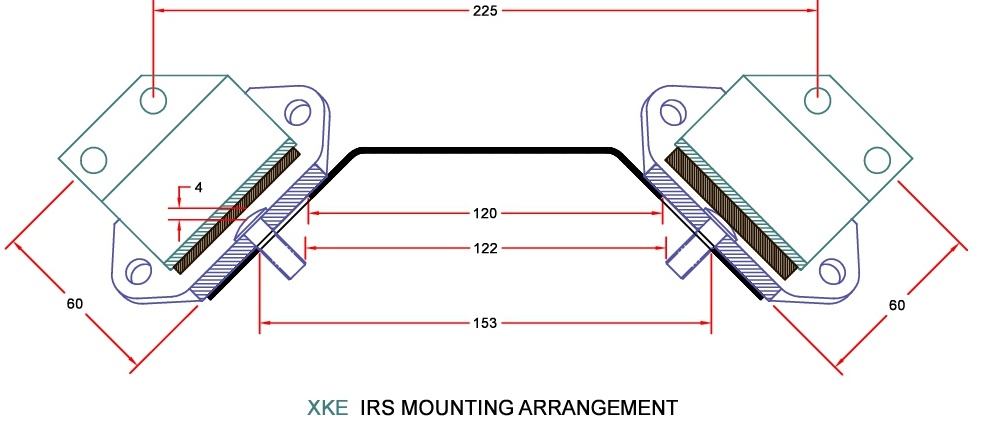

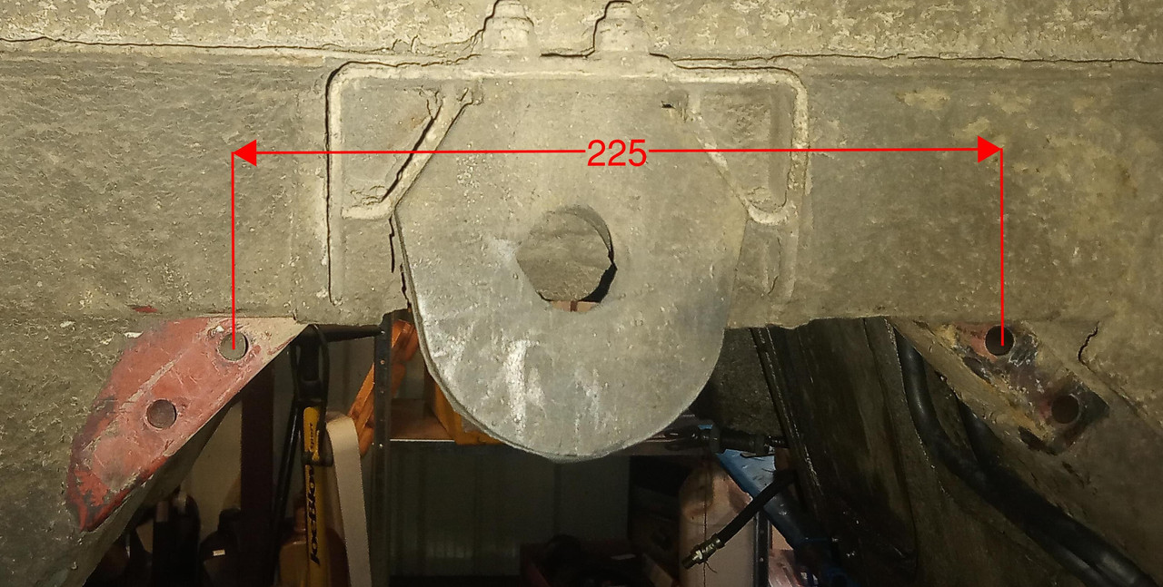

Here is pic showing that the top bolt holes for attaching S3 IRS mounts are 225 mm apart. This dimension dictates how much compression is required to fit the mounts. I'm trying to find out if S1 and S2 have the same dimension, can anyone advise? The question is for this topic in the General forum:
viewtopic.php?f=2&t=15799
Thanks.

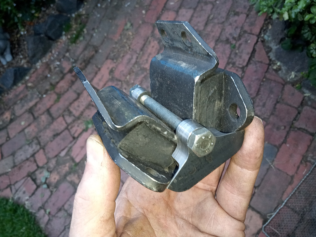

Here is my solution to the IRS mounting issue, applicable to all Jaguar IRS's, not just e-types:
Instead of trying to compress the mounts while installing the IRS, the mounts can be pre compressed and these small plates used to hold this compression while the mounts and the IRS are being installed, then the plates are removed.
So no podgering, levering or hammering is required, IRS installation becomes quick and easy. The plates hold the mounts compressed just enough so that, when the IRS is raised into position, all of the mounting holes simultaneously line up, bolts slide in.
Risk of installation damaging the mounts is eliminated, each mount is compressed to no more than its in-service extent.
Radial arms can be reliably reconnected while the mounts are pre compressed, no need to lower the car onto its wheels and rock it.
The clamping plates are held in position by a connecting bolt. Loosening/removing this bolt allows the plates to slide outwards and upwards, thereby all held compression can always be gradually and safely released.

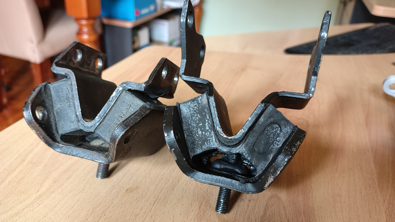

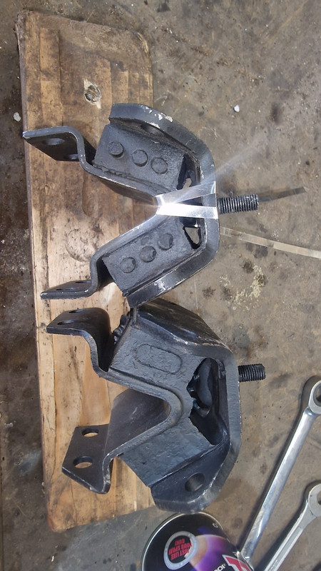

Here is pic of a new SNGB “upgraded” mount (height increased to 69 mm, rubber hardness increased to Shore A80) being pre compressed:
Here is the same mount being held at its in-service height of 60 mm, ready for installation:

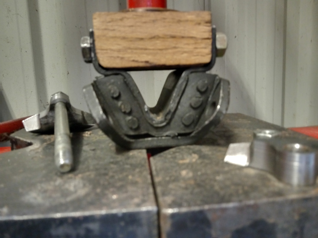

Ok, it would be great to be able to share what it is costing to develop this thing, I’ll make them as cheaply as I can, happy for any suggestions.
Kit could comprise eight of the plates, four of the bolts and two auxiliary blocks for use during compression.
The plates were 3D modelled, different arrangements tried till we found one that was substantial enough while still leaving plenty of room for installing the IRS mounting bolts.
Stp/step file generated so production is by NC machining after a rudimentary holding jig was built. Machinist has suggested some mods which, together with a more sophisticated jig, will reduce the time and therefore unit costs. Working on this atm.
The bolts are proposed to be M8 x 100 hex head set screws to DIN standard 933, Grade 8.8, plain finish, fully threaded. 100 mm is the minimum length necessary to enable the largest to date (69 mm) mounts to be fully decompressed simply by unscrewing the bolt. Normally you would never need to do this but …
100 mm bolts (partially threaded) have thread length around 22 mm, we need at least 32 mm thread length to fully compress, this is why we’ve opted to use fully threaded.
Two auxiliary blocks enables pre compression using a suitable vice, as shown in the included video. When compressing, the mount is bolted to the upper block (using its own bolts); to ensure that the mount will not spread instead of compress. The side bolt holes through the upper block are large diameter so that the bolts cannot be pressed on, when compressing the mounts. The lower block is merely to accommodate the mount’s bottom stud, via a single end hole. To date (photos and videos) the blocks are wooden, for the kit we propose them to be steel, NC machined, each 60x60x20. The two blocks will be made the same, with both side and end holes, thereby interchangeable. The blocks will be for e-type. Other jaguars will require blocks of different dimension.

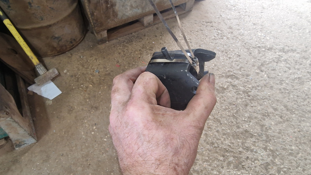

Post by politeperson » Sun Apr 14, 2024 8:14 am
My solution, involving metal zip ties.
lowact
Posts: 773
#13 Re: IRS mounts
Post by lowact » Sun Apr 14, 2024 1:22 pm
That's brave. Aim to compress the mounts close to 60 mm, i.e. by simple geometry:
