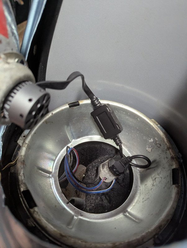

#17 Re: Led H4 headlamp conversation kit
I've just fitted LEDs from classic car LEDs to mine as I rebuild it. I've also done the conversion in my beetle a few years back and it makes a massive difference to visibility.
The bulbs come with a mount that fits the original H4 fitting, and a tail with ballast that plugs into the old original connector - plug and play. You have to carefully tuck the ballast and connector around the edge of the bowl to allow the assemblymto fit back together:
Can't test or show any beam pics yet as my bonnet isn't fitted!
