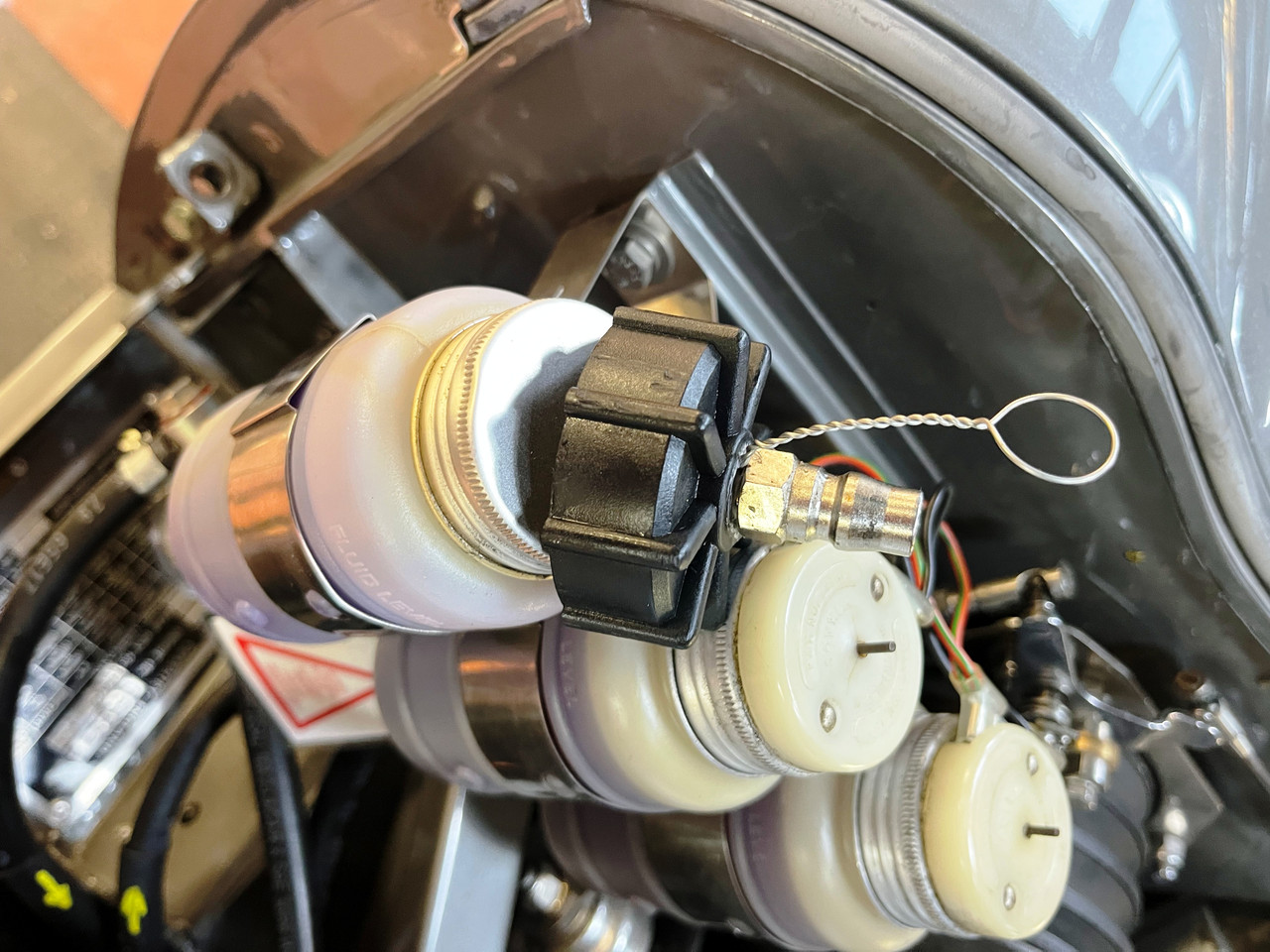

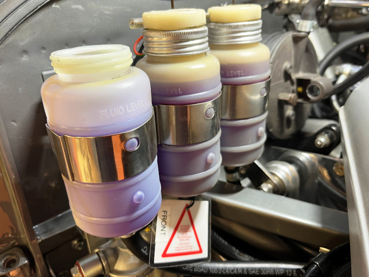

Post by rfs1957 » Sun Jul 24, 2016 7:30 pm
I've had 3 clutch reservoirs on my 3.8 since I owned it, I must be in for £75 by now and I've still got a car that leaks and probably has the wrong cap.

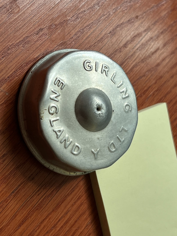

N° 1 had been on the car since 1989 and might have been original or a copy ; it fitted the bracket, and had the Girling lid seen here in the pictures complete with breather. I changed it because the exit was cracked, tho' it did have the steel insert.
N° 2 came from SNGB and was too small in diameter (required a rubber sheath to be gripped), didn't have the steel reinforcement on the exit stub, and I was too tired to complain. It lasted 5 years before I got tired of the weeping from a crack around the stub. The Girling lid fitted it, and it never leaked from there.
N° 3 is recent, May 2016, seen above, from SNGB ; it fits the bracket, has the steel spigot in the outlet stub, but the Girling cap now won't fit it ; it comes supplied with a plain alloy cap, which leaks because the cap collar binds on the body of the bottle before the rubber seal in the cap has been sufficiently compressed ; the bottle collar is 13.70 mm high, the cap depth to the rubber seal is 13.90mm - so there is no way this can work.
Seen here : new cap on left, Girling on right.
The adjacent brake bottle cap will fit the new clutch bottle.
And the Girling cap will fit the brake bottle.
So Q1. which would be the correct cap for a March 1962 3.8, and if it's the new plain one then Q2. WHY can't repro manufacturers get something as drop-dead obvious as collar lengths correct, and if it's not the plain one but the Girling that is the correct one, Q3. WHY can't repro manufacturers make bottles that fit the original caps ?

Had this problem Rory. Original bottles cannot be repaired (I tried with a plastic weld gun), repro caps will not fit original bottles, original caps will not fit repro bottles. Older repro bottles will not fit the bottle holders. I found an original cap and with a bit of coercion it can be forced onto the repro bottles. The repro caps are the wrong shape, colour and thread.

#20 Yet another CLUTCH bottle
Post by rfs1957 » Sat Dec 20, 2025 11:51 am
Nine years on, and have things improved, please ?
Since 2016 I have been using the rather nasty SNGB plain-cap on the clutch reservoir I had from them, which has 1. no air-bleed, and 2. which required me to make my own seal as the one supplied was too thin, as my Girling cap - not strictly "original", but period, and same thread - won't fit.
See post #14 above.
I could live with the SNGB cap, I suppose, BUT whilst I can pressure-bleed the brakes, which use the SNGB bottles, and which will accept the Girling cap, my clutch one won't accept either that cap OR the pressure-bleeding cap, which is PITA.
Has anyone had a clutch bottle C18616 recently from SNGB and can tell me if the threads have improved ?
