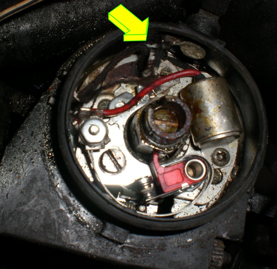

Peter,
I had a similar issue (misfiring, difficult to restart when hot etc) recently and discovered the low tension wire (arrowed) in the distributor was stripped and down to just a few strands:
Ordered new LT lead/cover, fitted and not misfired since. Although in my case I think the restarting when hot is a different problem and on David's advice I ordered a new coil, haven't fitted yet so can't tell you whether this cured it.
