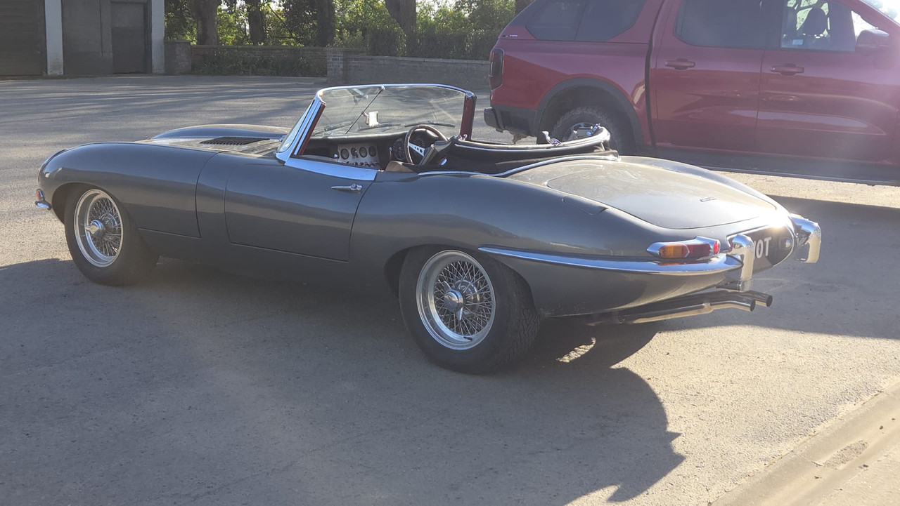

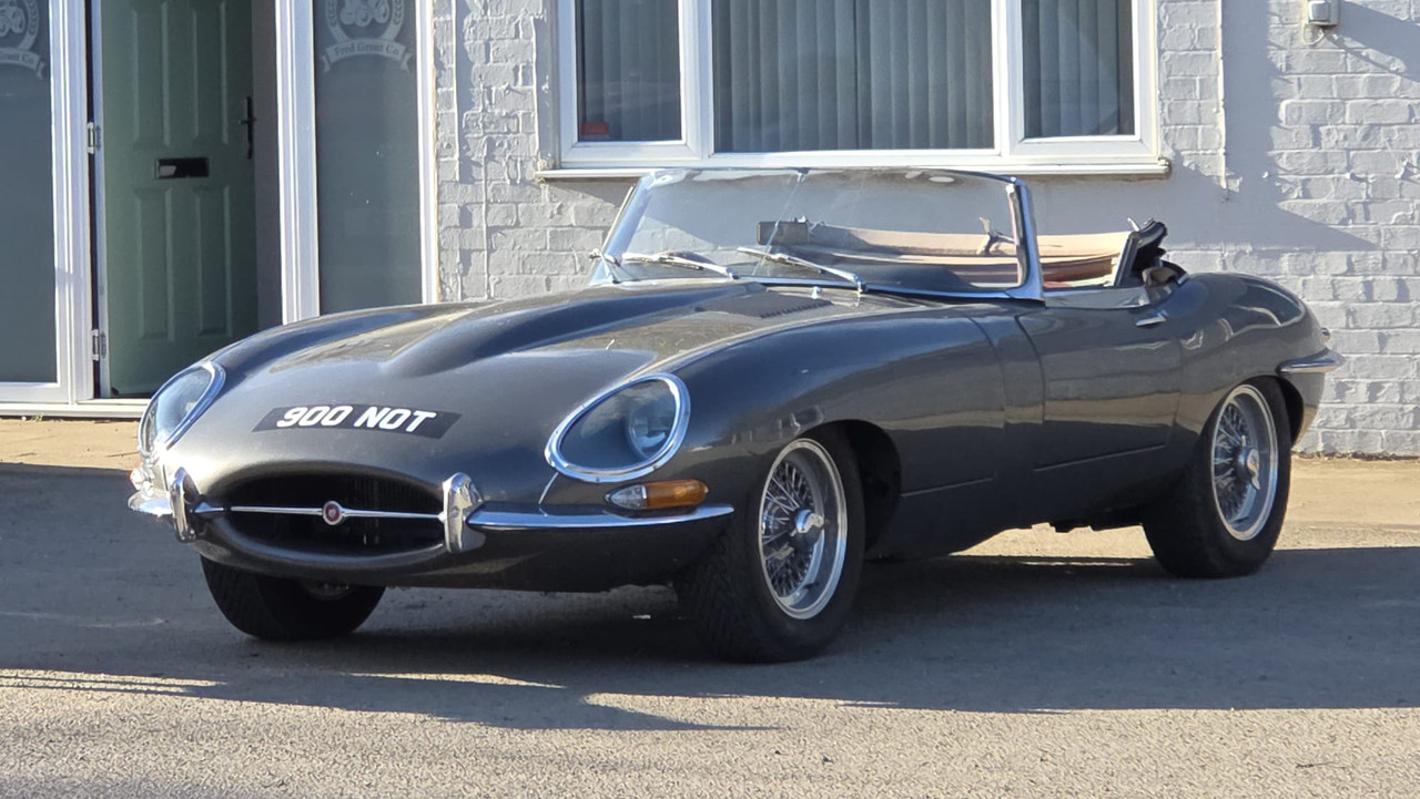

Post by politeperson » Thu Jul 30, 2026 4:07 pm
This is what my version came out like. Sorry about the dust and the sun. Can you see it in your region?
My local guys have the old Jaguar paint cards and they seem to be able to find all the colors I ask them to.
If you are looking for Opalescent Gunmetal, they think it is J1052/33661
They send paint all over the place.
