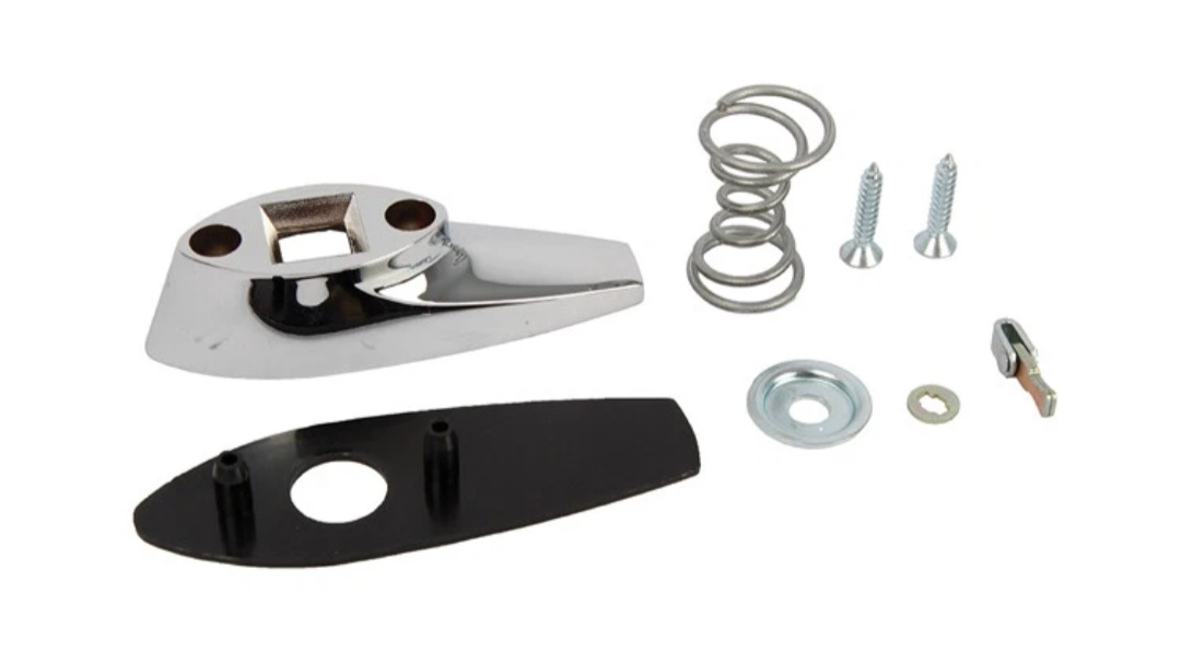

The mirror is the later type fitted to S2 and S3 with the long swan neck stalk and the problem is where the base meets the long arm that carries the mirror head. At that point the mirror can vibrate distorting the rear vision. Under the base there is a large spring, held in place with a large diameter washer and a central lug. I would like to know how I can remove the washer and spring to replace them.

The spring is held in place by a shaped washer....washer has a slot fitted to a T bar shaft..hold the T bar with grips and twist 90deg... washer and spring now pulls off....Steve https://ebay.io/m/8YBi2L
