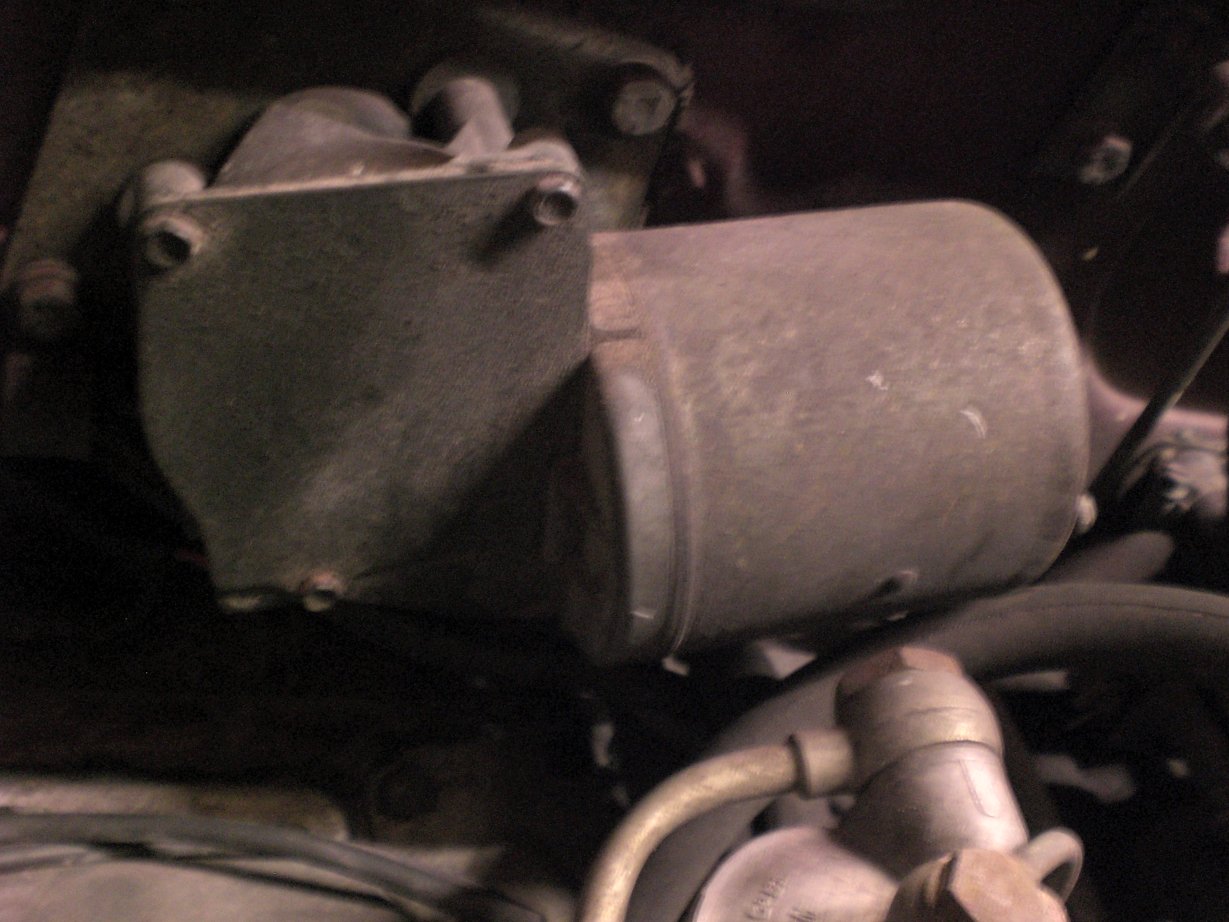

Post by Shaguar » Wed Jun 25, 2008 9:00 am
David,
Not sure the model but here is a photo insitu in the car:

Post by Heuer » Wed Jun 25, 2008 2:54 pm
That is the later motor (Lucas type 15 I believe) and works is much the same way as the DL3. Problem with these is the gearbox grease turns as hard as wax and that, along with insufficiently greased wiper rack can cause the motor to stall and possibly burn out. Looks like it has not been serviced/restored recently so I think you need to remove it from the car and dismantle. Clean out all the old grease, repack the gearbox, lubricate the bearings and bench test. You may find the brushes are worn and worth replacing. It is unlikely the windings will be damaged otherwise you would have been reporting a burning smell and smoke! Whilst the motor is off check the wipers for free play and lubricate the rack pivots, joints and spindles. You can access the rack through the centre console although space is limited. Be careful not to damage or move the park switch which is on the rack itself.

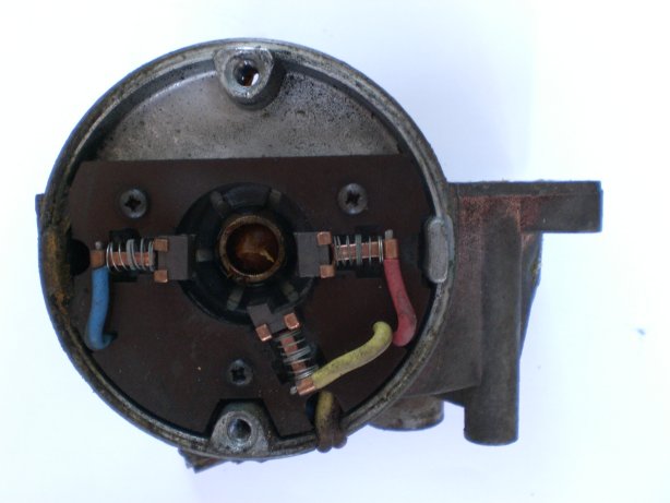

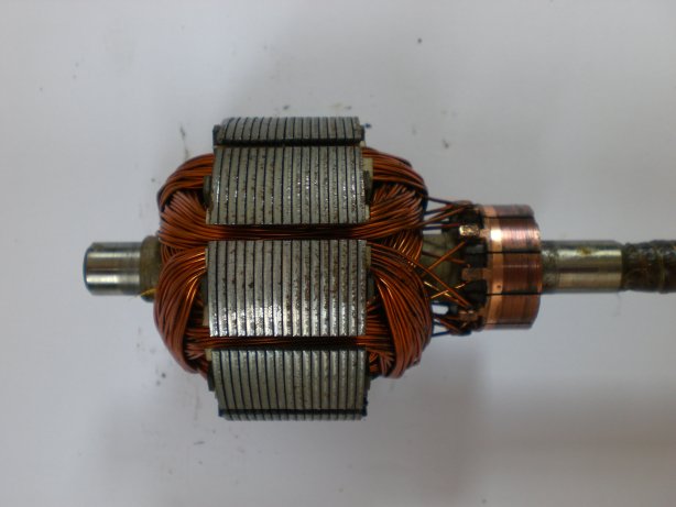

Removed motor this morning and stripped it down. Hand powered the wipers, tried also running the motor with no load. Internally all the worm drive and gear looks fine.
The following two pictures show the bushes and although worn they appear to be okay. The second picture shows the armature which I've tested with a ohmmeter (across commutators to spindle) and this is showing open circuit as it should. So I guess I'm baffled :? , the only other component on the motor is the limit switch but I assume if this was faulty it just wouldn't stop at the park position.

Post by Heuer » Thu Jun 26, 2008 2:37 pm
To be clear - does the motor run on the bench with 12v+ on the red/green and earthed through the body? Not familiar with this motor and I do not have a a S2 wiring diagram. Is the limit switch on the gearbox or on the wiper rack?
